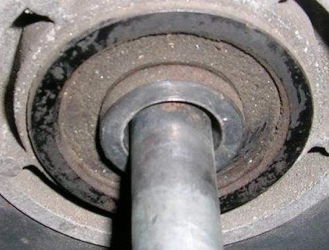

That's weird.....both of my 750 axles are 20mm. Here's a picture I took of a 750 rim with the 907 axle going through it....

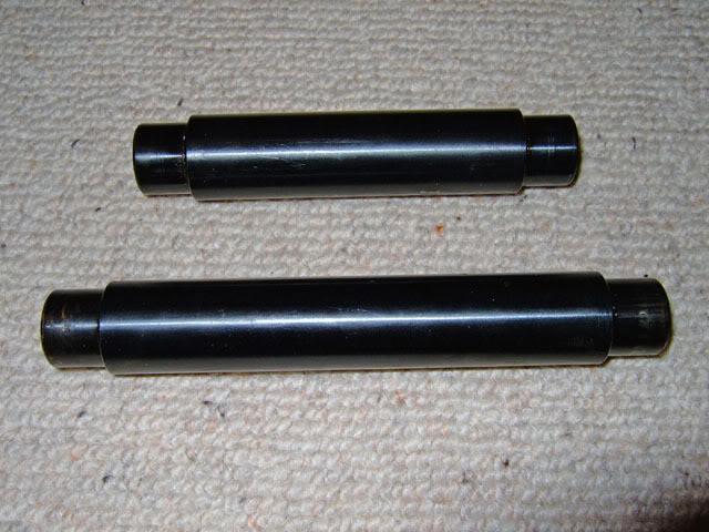

On my bike, the only stepped spacer for the bearings is with the front wheel for the 17mm front axle, which is why I came up with this diagram a few months ago...
This is what I pulled out of the hub of my rear wheel.....notice that there is no special stepping to the spacer that goes in the hub...
Does this make more sense, now?

I think your rear spacer could be a "gift" of the last owner as mine looks like the front one with the difference that the front spacer is 15,7mm wide, the rear only 12,2mm.
have you really measured the actual axle. The pic looks normal to me considering that there`s no original bearing spacer in which case you have a gap of 1,5mm. (in radius).

paso750 wrote:have you really measured the actual axle. The pic looks normal to me considering that there`s no original bearing spacer in which case you have a gap of 1,5mm. (in radius).
If you notice, though, that is the axle going through the sprocket carrier side through the rear wheel. There is excess clearance all the way through the sprocket carrier and wheel, not just the wheel...
Yes, I used a micrometer on the original axle from the "Pile of Paso". Now for the interesting thing......the rear wheels from my '87 and both '88s are the same, so.....I have three examples of the rear axle being 20mm and not 17mm. Also, on the Paso parts manual, you can clearly see that the front wheel spacer has a step to it, but the rear one does not (TAV.22 E3 - part numbers 037077293 for the front and 037080290 for the rear). Your two spacers definitely look original, though.......some interesting things we've been finding, lately. :thumbup:
