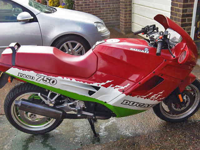

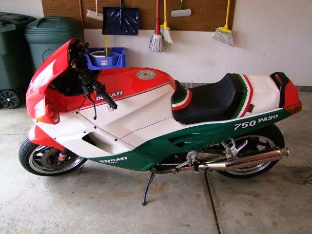

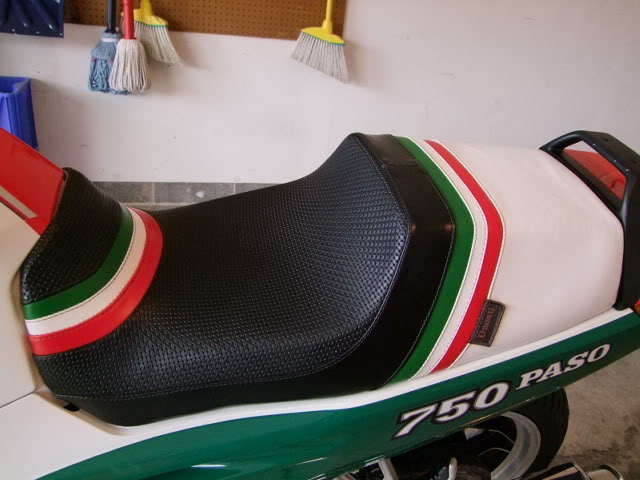

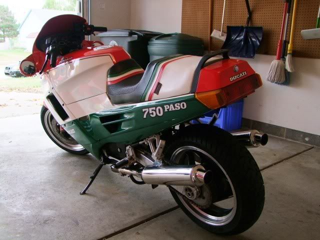

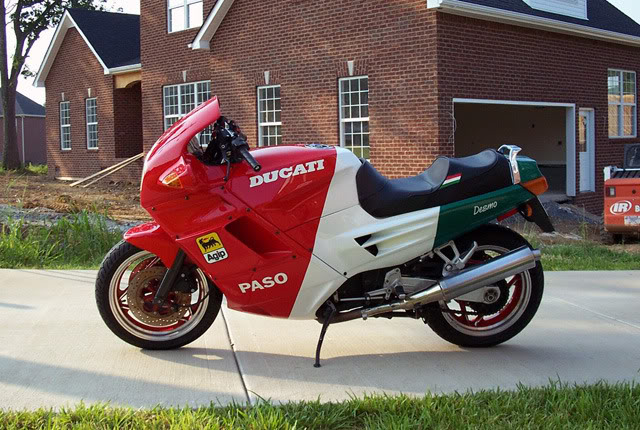

I`ve seen a lot of tricolore Paso and none of them really looked good. Some really ruined a good looking bike.Speaking of body i am thinking of going tri-colore. What do you think?
Here`re some examples:
(For sale: 1988 Ducati El Paso 750
I`d consider this one the best looking tricolore I`ve seen so far (It was on ebay recently). What makes it nicer are some details such as how the tank was painted, the white that goes to the taillight or the use of the stripes on the tank. This paint scheme shows the effort that was put into it.
