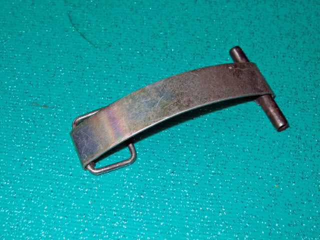

if you still can get the clips from a Supersport airbox as you had mentioned lately, take them.

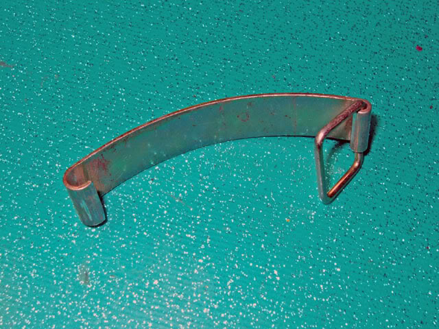

I knew I still had one or two somewhere (from an SS <96) so after finding them I removed the pin and tried to cut off a small part of the rolled in side with a multifunction rotary tool. That square wire is a little wider than the clip of the Paso so you have to grind off some material from the airbox lid but otherwise it works just fine.
