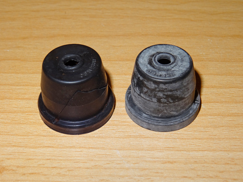

Are the 2 rubber dust boots (clutch and brake side) the same?
Derek
Posts: 768
Re: master cylinder rebuild - a few thoughts and my experien
Post by Derek »
Good info there and a nice tip about the nail trick :thumbup:

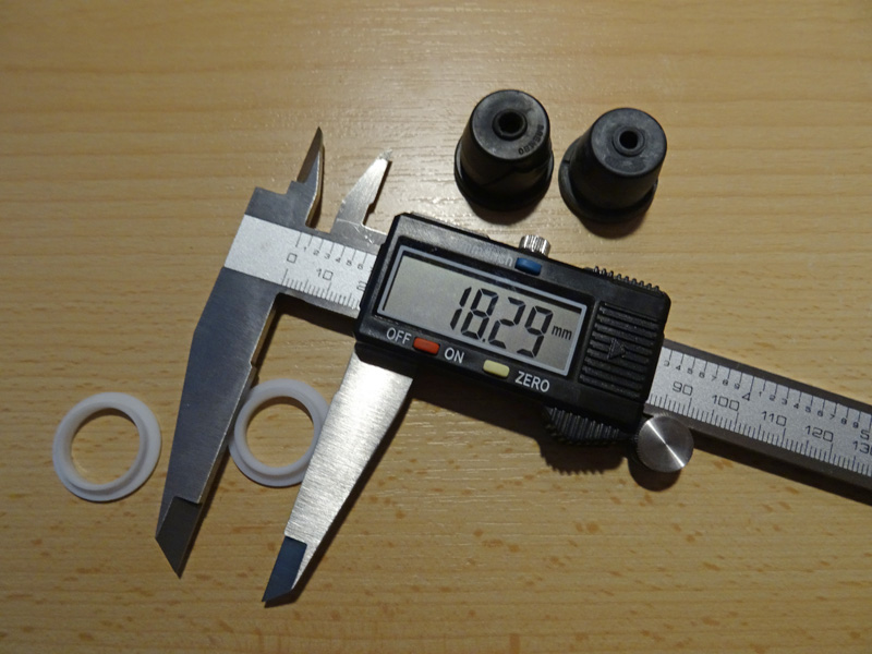

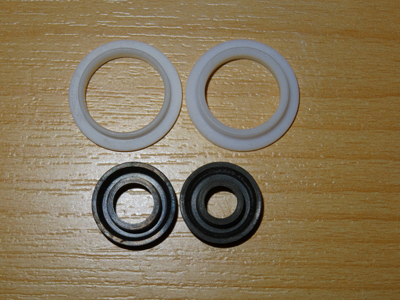

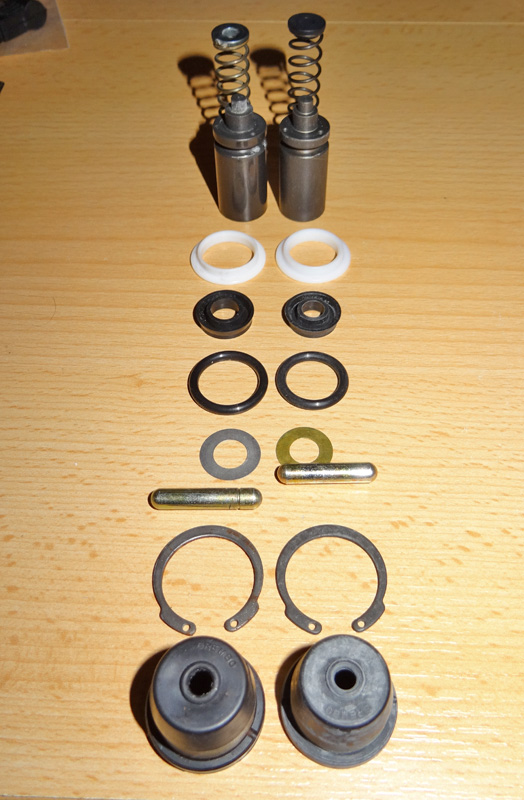

Frank, here're the used parts of the PS16 on the left vs. the new PS15 parts on the right.
The outer diameter of the white plastic rings is the same as is the outer diameter of the edge where the rubber boot sits. So I'm lucky and the rubber boot of the PS15 kit will fit in the PS16 m/c. The rubber boot of the PS13 rep.kit won't fit. It is smaller.
I wonder about the longer spring in the PS15 kit. The length of both pistons is identical. Maybe the depth of the cylinders isn't. I doubt the used spring set so much.

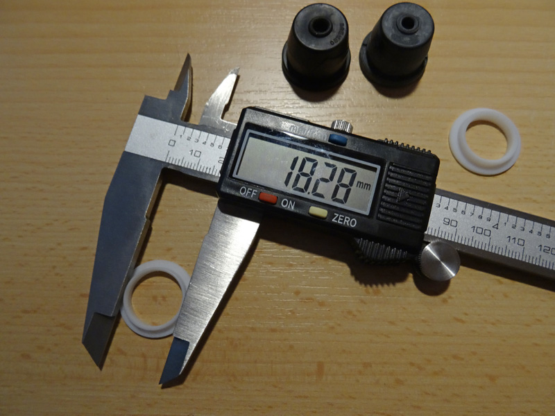

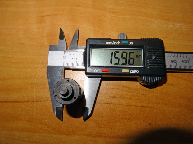

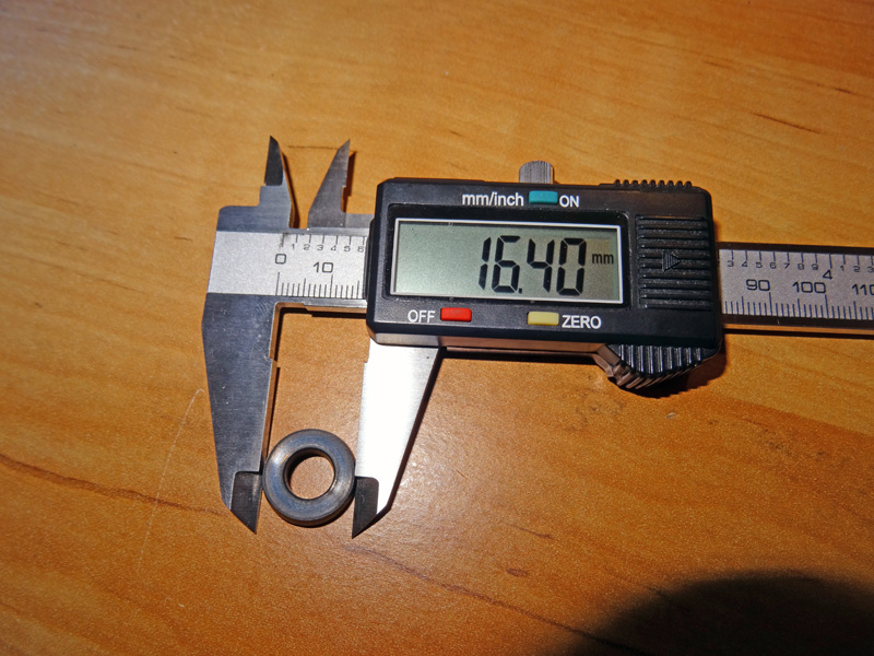

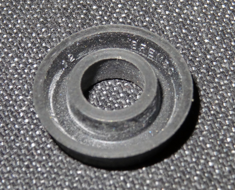

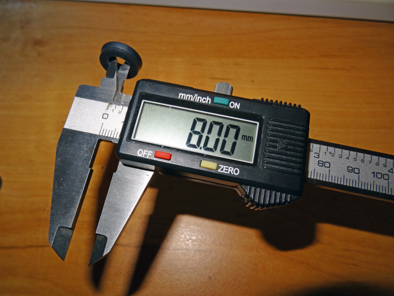

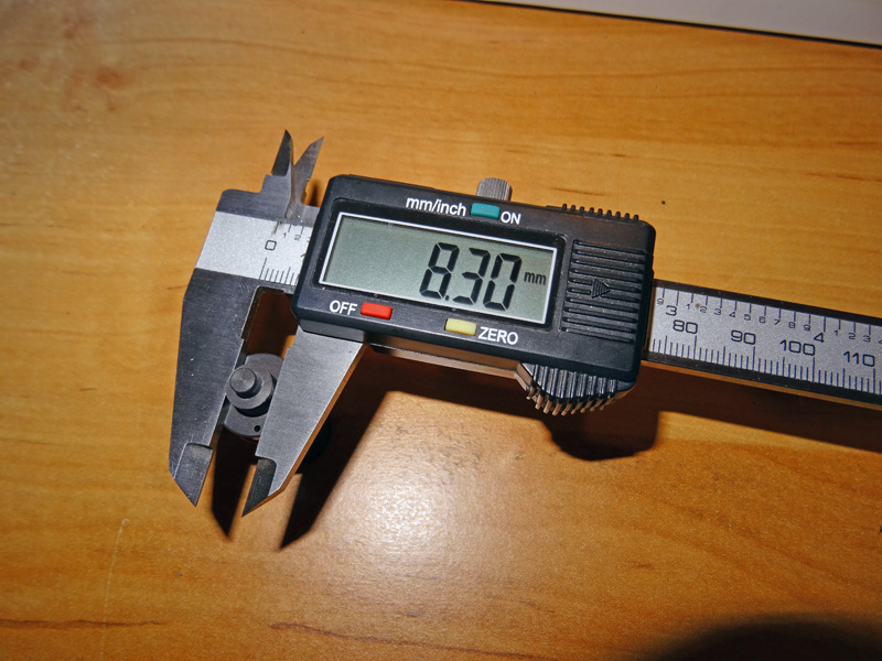

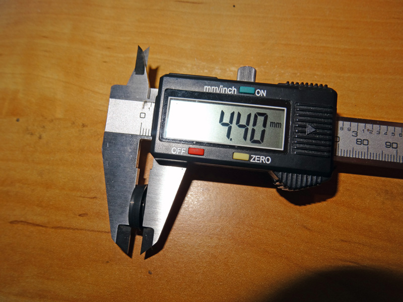

You know how hard it is to measure the dimensions of soft rubber parts. So keeping that in mind here are the dimensions.
PS16
Dimensions of the seal:
Height: 4,4mm
Inner diameter: 8mm (Diameter of the piston where the seal sits: 8,3mm)
Outer diameter: 16,4mm (Diameter of the piston 15,96mm)

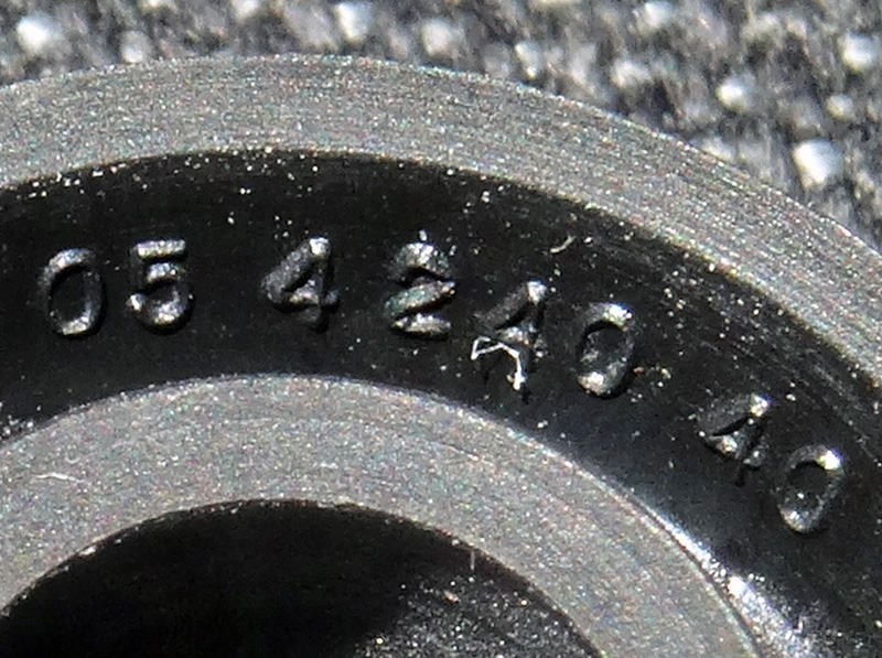

#05424050

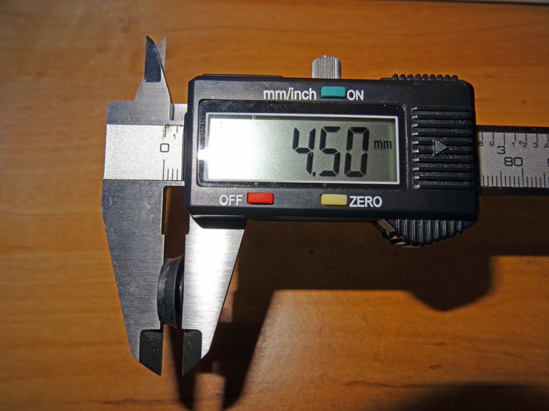

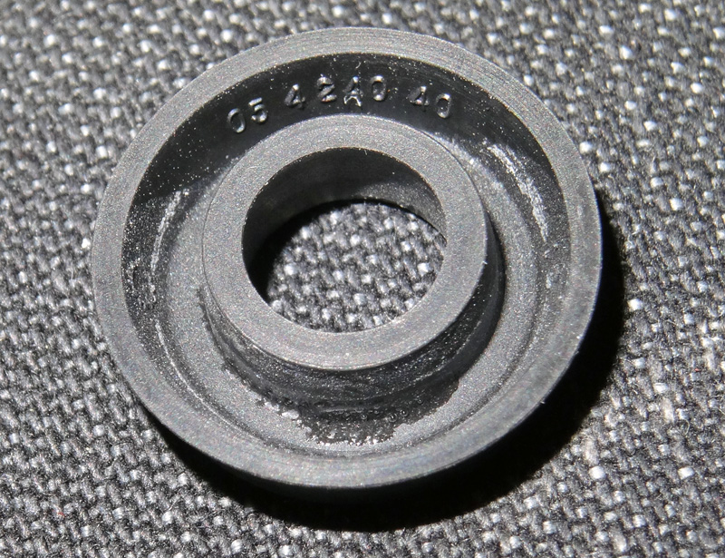

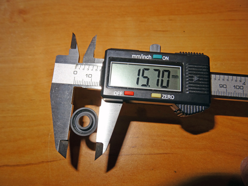

PS15
Height: 4,5mm
Inner diameter: 6,5mm (Diameter of the piston where the seal sits: 7,3mm)
Outer diameter: 15,7mm (Diameter of the piston 14,97mm)
#05424040

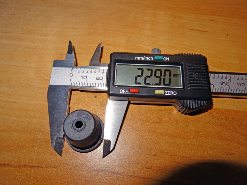

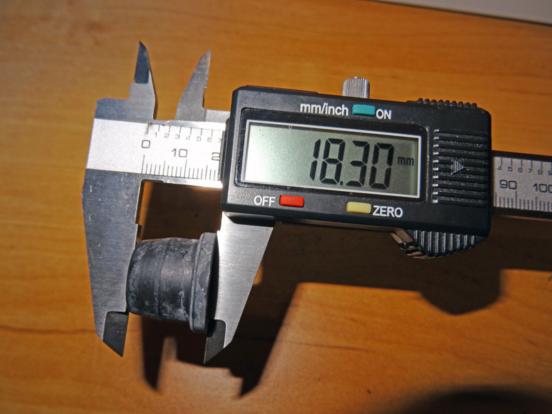

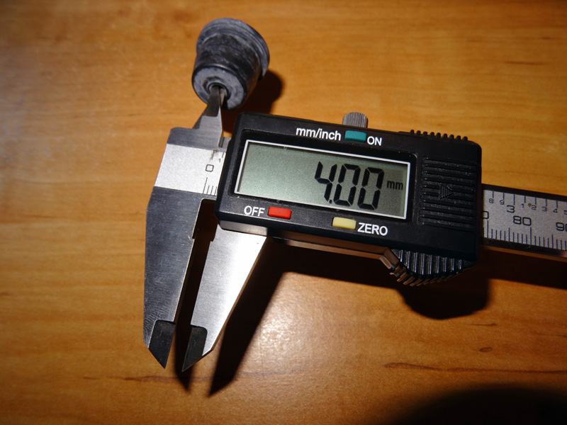

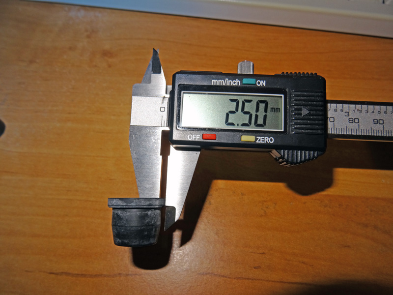

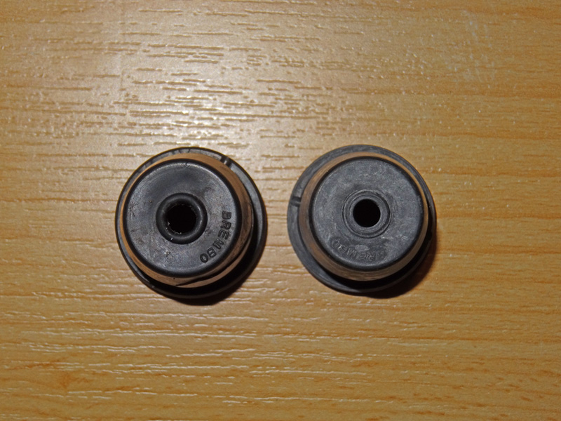

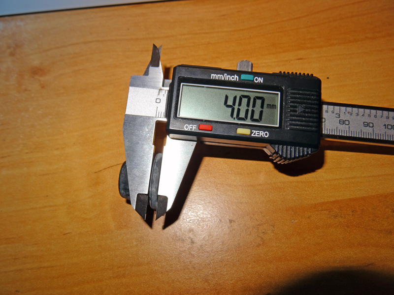

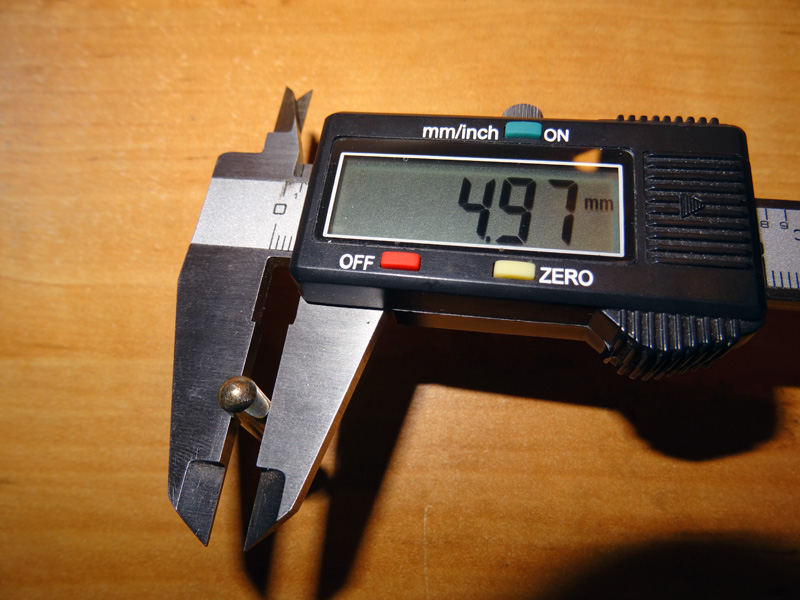

PS15/16 rubber dust boot
Dimensions of the rubber dust boot:
Hole on the top: 4mm (diameter of the actuator pin: 4,97mm)
Bottom (outer) diameter: 22,9mm
Height: 18,3mm
Height of the bottom lip: 4mm
Thickness of the bottom lip: 2,5mm

PS15/16
This is the correct order of parts:
Again, the seal should be fully seated on the piston. Instead of the silver disc the PS13 kit has there’s a black one which is fitted on the spring.
