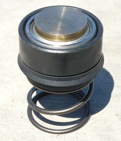

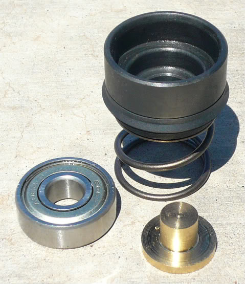

Mission accomplished my Duck is up and running and now it only has the normal funny noises that all the ducs have. Thanks once again for all the help, It seems simple now but I don't know how I would have gotten it done otherwise. for those who are still confused please see the two links to photos, the first shows the three parts that some others may need to fix the same problem I had.the second photo shows all the parts assembled. please note the roller skate bearing (it really is a roller skate bearing) p.n. skf 608zz I bought 2 on ebay with shipping for about ($10 US) then the piston assy. 19590023B (ducati p.n.) as I understand it you cant buy the seal separately so you have to buy the assy. (piston,seal,spring) bought from local ducati shop for about ($45 US) then the "button" which is unobtainable now, a friend of mine machined it for me, we used a steel/bronze alloy, on the hardness scale it fell on the lower end of the steels. we used the dimensions that were posted earlier in this thread. it took him about an hour to cut and I had to buy a lot more material than I needed to make it ($25 US) by the way the bearing pushed in by hand (snug but no interference fit) and the button was machined also to go in by hand but no interference fit. after that...... bleed the clutch system(AAAAAAGGGGGGGHHHHHH!!!!!!!) I wont say anymore other than get a vacuum bleeder , youll use it for other projects eventually. Now that its past 100 degrees f I'm ready to go riding again Johnnie
