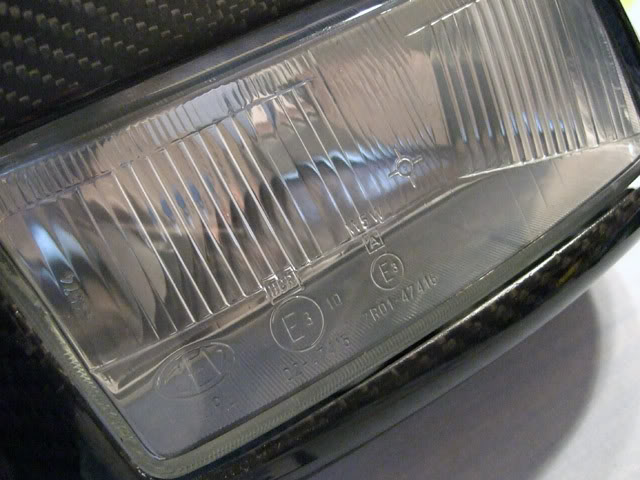

just would like to show what difference it can make when you clean the inner side of a headlight (using some chopsticks and a cottonball). Do not touch the chrome reflector and if at all only use very little distilled water to wet the cottonball. (don`t completely soak it).
Put your headlight on a towel, lens downwards and throw in the cottonball. Move it around with the chopsticks. If you want to turn the headlight around to see if you cleaned it all remove the cottonball before that.
beginning

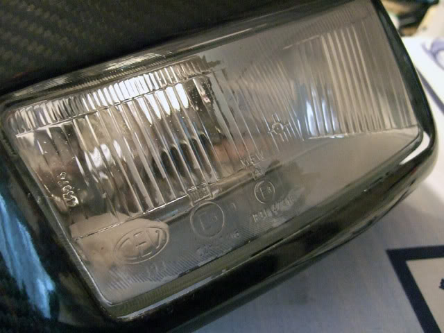

while (one half done)

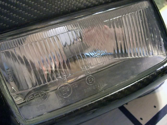

at the end
Actually the old beam of my Paso was even more dirty inside. A good indicator is when you can`t see the bulb inside clearly. A dusty headlight looks quite normal until you start cleaning it and see the difference ...
