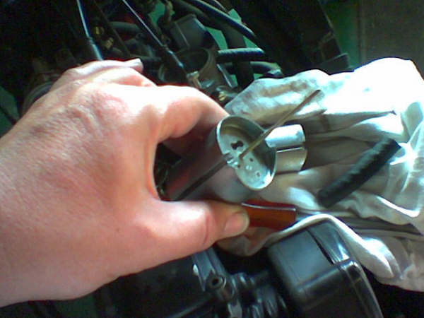

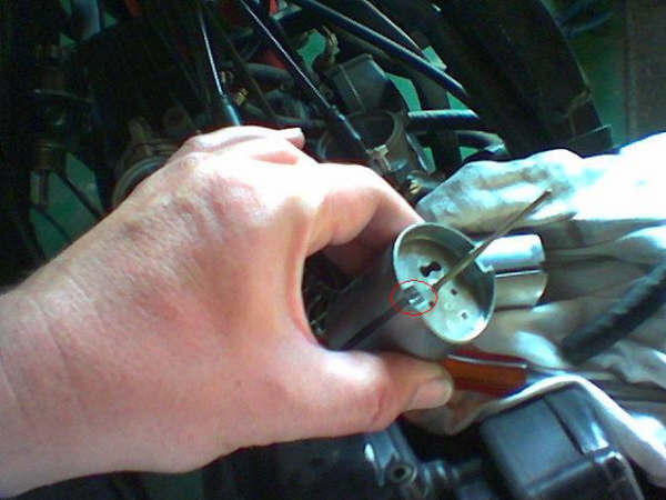

Is this the notch that you were talking about that affects the idling with Dell Ortos ?
I have put two pictures here because they were taken at slightly different angles.
Must I file these smooth ?
Thanks
Paul

Yep, Paul. That's them all right. The end of the throttle-stop screw cannot work precisely when it's bearing onto a surface like that. It would be impossible to set the idle properly, and the resulting idle would be impossible to predict.
The slide is very soft metal, and is very easily repaired with a needle file. The screw will probably have to be turned in a bit to compensate for the metal removed, but not neccessarily, because you'll be starting from a problematic situation, if you know what I mean.
If you're not used to setting and ballancing the carbs at idle, one of my first posts, maybe the first one, talks about that. I'm happy to answer any specific questions you may have, if I can.
Tell you what, Paul - you and I can see the wear notches in your pics, because we know what to look for. In fact, I myself had to look hard to see them (it's been a while since I dealt with my own). Other people might look at the pics and wonder what we're talking about. Would you know how to put little white arrows into the pics to point them out? I'm afraid I don't.

Thanks, I'm going to be doing some gentle filing tonight.
I managed to get the photos directly on the page by using the MSN Spaces facility (free hosting). I struggled with getting the image to display here because the closing "img" entry was always on the following line. This made the address be displayed instead of the image. Once I worked that out, and made sure that the closing "img" entry was on the same line as the address, it was simple.

I hope this makes it clearer
Paul

Good stuff, Paul. If anyone is still puzzled by what we're on about, it'll be much easier to explain now. Thanks.
