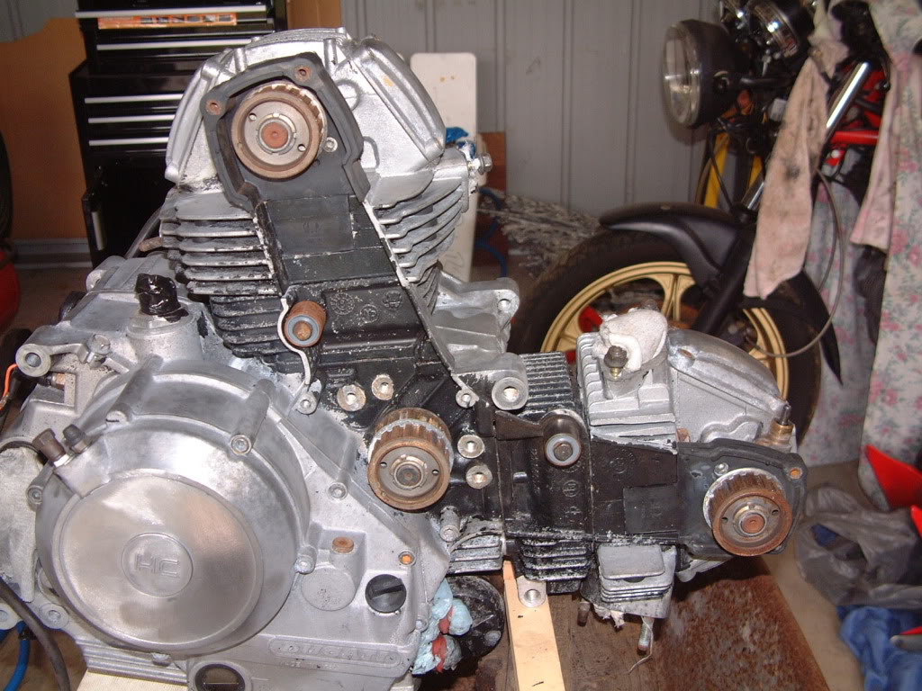

paso750 wrote:ok, you asked for it. :mrgreen: Go back out in the garage, look for a wire and tie that rear caliper to the frame - now. You may also replace that rag in the engines swingarm bushing with tape as the rag won`t really protect from dust.
Nice engine stand btw. :)

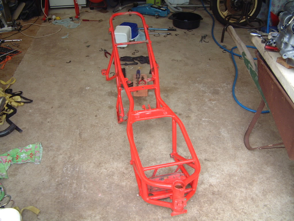

At this point I'm going to keep it pretty much stock.I never really bought it to ride ( which is the first time I've done that ) but to save it from rusting away to nothing.And besides I don't have any money left to buy any extra bits just at the moment :cry: To be honest this is my first project and when I mentioned about comments or suggestions I probably worded it wrong.What I meant was how to's etc liking stripping the paint off or as you mentioned earlier about putting the extra bracing near the steering head.Is there any specific tube size for this or anything special I need to know before welding it on.
Andrew
Posts: 5570
Instead of asking yourself what you`re doing you should realize that you have already arrived at the turning point of your project !
Remove the type plate from the frame, make pictures of the stickers if there are any and then the frame is ready for mediablasting and powdercoating or a new paintjob. When the fork is rebuild you can already start reassembly. :thumbup:

The frame is Chrome Moly (CrMo) so a bicycle builder is your best bet to get some tubing that will add what ever bits you need, like the braces on the headset.
Painting the frame is big pain, but if you have the time and energy, it shows nicely. I have the tendency to just fix the dings and call it good.

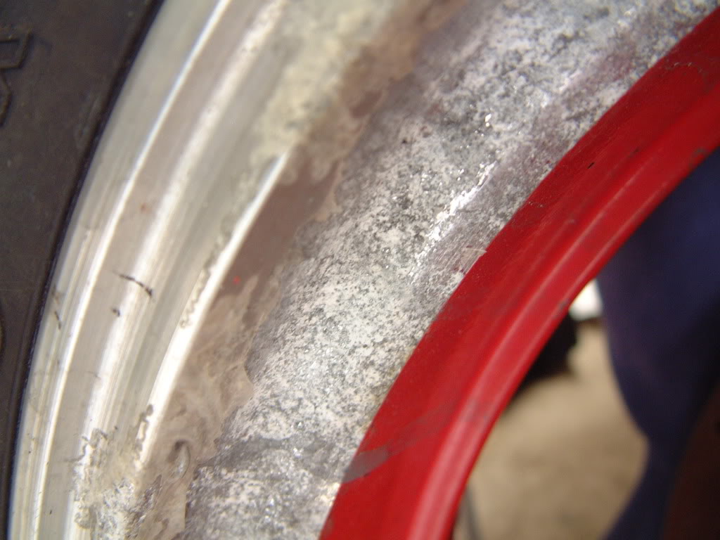

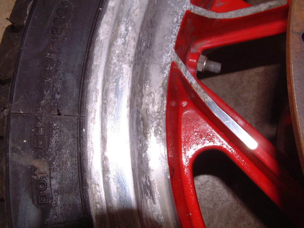

Not too much to report as most of what I'm doing is slow going,i.e. cleaning and polishing :shock: :lol: .

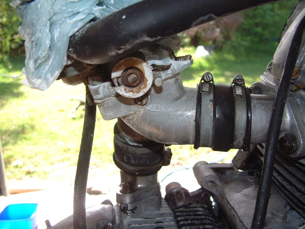

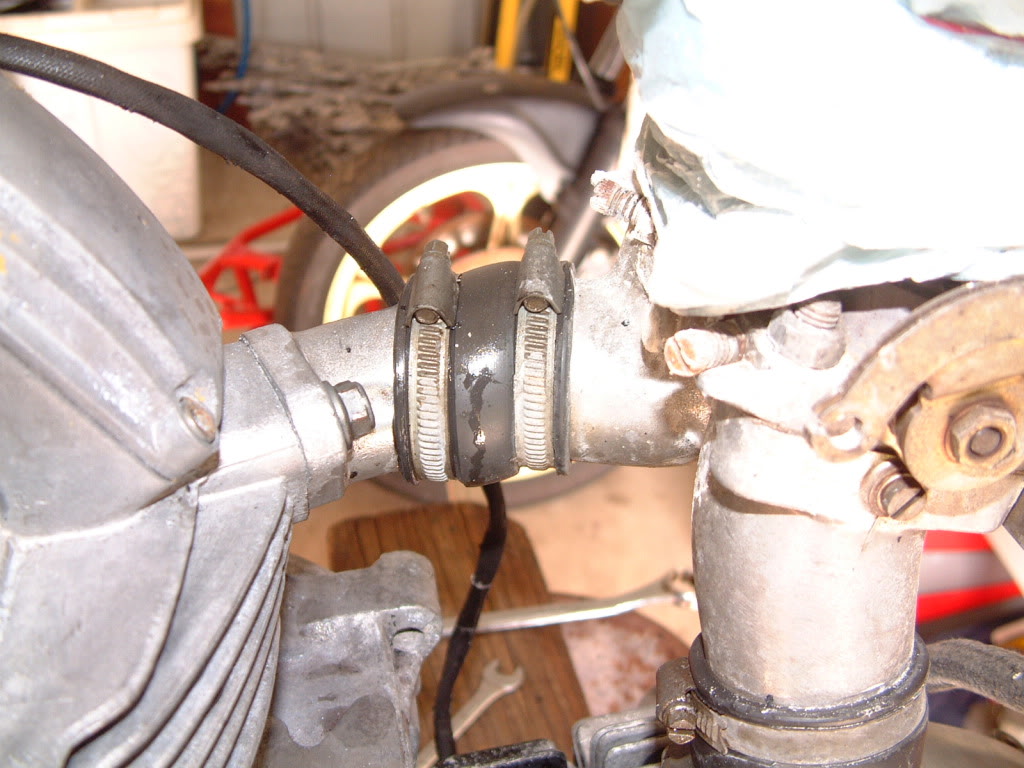

It looks like I'll be needing some new inlet rubbers.Does anyone know who can supply these?.

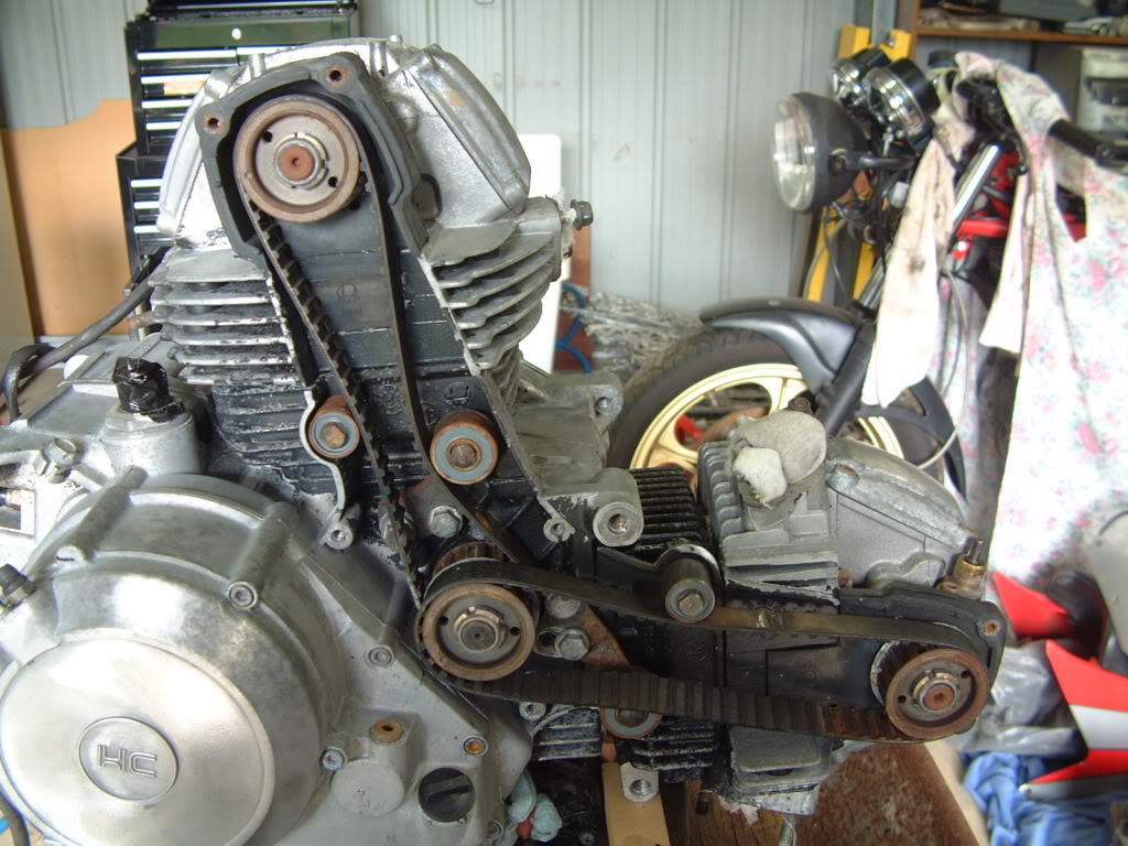

I've removed the belts so I can clean up the pulleys and rollers....

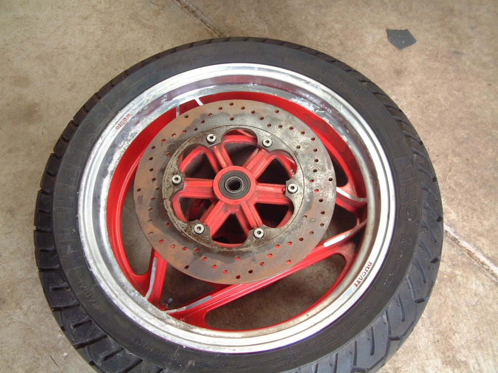

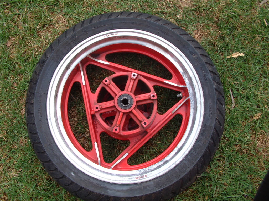

....and have started cleaning up the rims.I was going to completely strip the rims ( and still might ) but the paint is not too bad.There's a spot or two of corrosion in the paint but generally good.
I also removed the disc for better access.
It's Australia Day here so I'm hoping to spend the day cleaning up the rims.I've started with 120 wet and dry but it's not coarse enough to get through the corrosion quick enough so I'm heading out to find some 80 grit.
