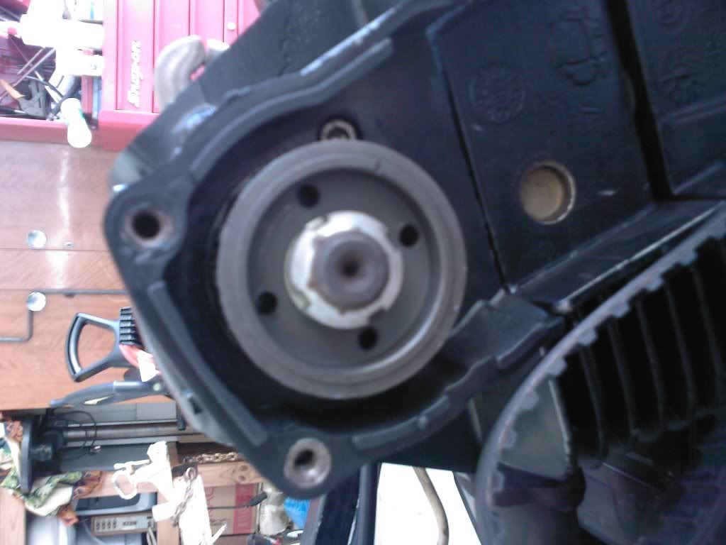

Thanks for the reply. I am trying, to no avail, to insert a picture of my timing gears. They have a washer on them which is the same size as the gear, which prevents the belt from smoothly pushing into place. Arr
How do I insert a picture to show you what I mean?
Is the washer really needed?!?
Took of mine belts w the same problems, what a PITA....
Looked at my M900 -97, no washer there and works w/o problems.
Maybe Ducati later realized the washer wasn`t needed and skipped them? Or have I missed something?

After several hours of cursing and making numerous phone calls to the Ducati bike shop where I purchased said belts, it was established that they had supplied the wrong P/N belts. I have just proven the old adage, "you can't fit a square peg in a round hole". The original belts I removed had half round teeth where as the new belts have square teeth. Second lot of new belts arrive tomorrow, hopefully!
One of the phone calls made, for the above, established that the washer is easily removed and that they are not required. Apparently they were only used on a few models then removed altogether.

Sorry guys just checking out my new found photo input skills, thanks to h1a.

kirk332 wrote:...established that the washer is easily removed and that they are not required. Apparently they were only used on a few models then removed altogether.
I have heard of some people removing the washer that forms that lip with regular pliers or Channel-lock pliers, but I cannot confirm this, plus yours look like they are held into place by the cam nut. My Paso didn't have those washers on them, so it was fairly easy to slip them over the pullies.

I have removed spacers long time ago and no anykind of problem. Only much easier to change belts... :evil:
