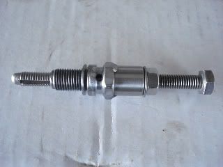

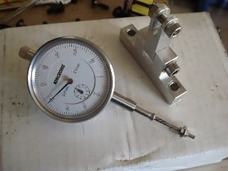

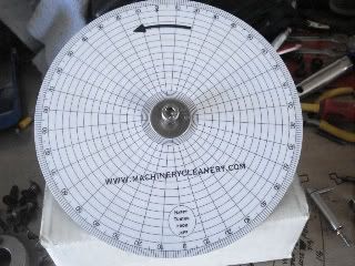

Before I could do any measuring I made up some tools i.e.degree wheel, pointer, mount for dial indicator, piston stop, extension for dial.Alternatively you can buy them from parts suppliers.

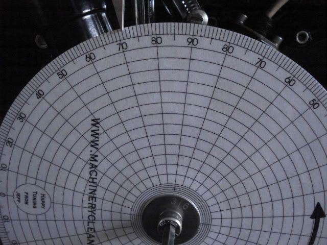

The first step is to set the degree wheel to zero.
1. Remove both spark plugs.
2. Mount the degree wheel on the alternator end of the crank.
3. Mount the pointer.

5. Screw in the piston stop and very,very gently rotate the engine until the piston
rests against the stop.BE VERY,VERY GENTLE WHEN ROTATING THE ENGINE WITH THE
PISTON STOP IN AS YOU DON'T WANT TO PUT THE STOP THROUGH THE TOP OF THE
PISTON.ALSO, DO NOT ROTATE THE CRANK A FULL 360 DEGREES WITH THE STOP IN AS
THERE IS A CHANCE THAT THE VALVES MAY MAKE CONTACT WITH THE STOP

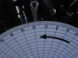

6. Loosen the degree wheel and set it to 0 deg TDC,without moving the crank.

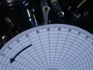

7. Unscrew the stop and rotate the crank past TDC just enough to allow the stop to be
screwed back in.(My stop takes up 38 degrees of rotation so I rotate the crank about
50 degrees).Screw the stop back in and rotate the crank very,very gently in
reverse(clockwise) until the piston rests against the stop again.
8. Take note of the angle on the degree wheel.As mentioned earlier mine is 38 degrees.

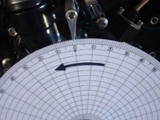

9. Now loosen the degree wheel and set it to half of the angle noted in step 8.eg.If the angle
noted was 38 degrees then you would set the degree wheel to 19 deg,again without
moving the crank.
10. Unscrew the stop again and rotate the crank forward just enough to allow the stop to be
screwed back in, rotate the crank back gently until the piston touches the stop
again.Repeat until the degree wheel reads the same either side of 0.The wheel is now set
correctly.

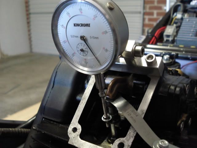

The next step is to set up the dial indicator.
1. Remove the valve cover and screw the dial mount in it's place.
The plunger on the dial should be almost all the way in when the valve is closed.
Ensure the piston is at TDC.
2. Set the indicator to zero.
3. Insert a feeler gauge to take up the valve clearance,mine was .01mm(.004").

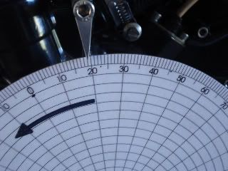

1. Rotate the crank until the indicator reads 1mm.Take note of the angle on the degree
wheel,mine was 19 degrees BTDC.
2. Continue to rotate the crank until the indicator reads 1mm before the valve closes.Take note
of the angle on the degree wheel,mine was 71.5 degrees ABDC.

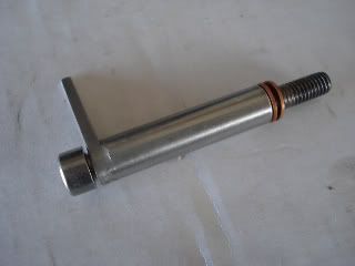

What a difference this has made, I have a new bike. After fitting the new offset keys the timing measures,
horizontal cylinder 106 deg l/c, vertical cylinder 106.5 deg. It idles and accelerates sooo much smoother now, doesn't shake
like a dog shit'n razors. It has stopped back firing every time I go to start it, which was embarrassing,and starts a lot easier.
I got the keys off Brad the bike boy.At $49 each I thought they were expensive for what they are but with the results I got I guess they were worth it,should have done it a long time ago but thought it was only a job for the pro's. It has been a very rewarding job and wasn't that hard to carry out.There is a lot of info on the net to help as well.Here is a couple of good sites that I found:
