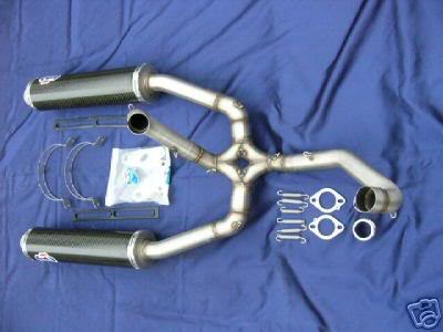

The ideal in the header cross would be to have it in the same diameter as the rest of the tubes just like this Termignioni system
There are some guys that drive around with completely open header crosses but I don`t think that is good. The exhaust gas streams of both cylinders meet there and to my understanding there should be something leading the streams to the side or at least preventing that the streams directly hit each other causing turbulences.
I had my own middle part totally removed and replaced by 2 open halves. Then they were cut open and a machined new cross was welded in. (the cross has curved flanks, it`s not just a square)
There are no dynoruns that I know of so this is mainly theoretical and experimental.

I would think it`s vice versa. In whatever forum you look there is no proof of any advantage specially on an original engine. Not even a spaghetti header does much on an original bike w/o sport filter, open cans, tuned carbs etc. All agree though that the worst thing you can do is to totally remove the cross, meaning to just cut it out and weld a cover on both sides w/o anything that guides the exhaust streams. In fact the exhaust streams directly hitting each other could have a negative effect on performance and due to the worse flow towards the exhaust the exhaust gas and the header could heat up even more and on the longrun damage the exhaust valves.Someone said who seems knowledgeable that it helps at low revs and
is bad at high.
Howfar the original cross is really restrictive or not can be discussed. If you look at it each header tube splits in 2 halves and 2 halves make 1. If the split halves are in fact not smaller than the half of the headertubes I`d say it`s the best solution for an original bike and it should be left as it is. What a modified header cross definetely does is it makes it slightely louder (probably giving the effect to think there is more power)
