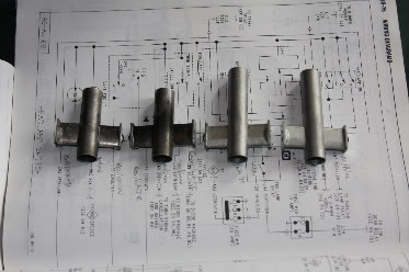

Took it out today with the 4.5 decided improvement, Think the next step will be to go back to the stock et's. What I would really like to try is an f7 or f8 et but seems to do that I will have to make my own. I think Mr goose was onto the right setup regardless of your displacement when it come to weber carb.
The arsenal to date

Put the stock ET's and Ac's back in.Left the idles at 75.The answer seems to be the tall 4.5 auxiliary venturi's. Acceleration is now even,smooth and easy to regulate. Still there is a hint of surging under 3000rpm on deceleration which I might address down the line with a different emulsion tube/float level adjustment or maybe just one more step down to 70 idle jet,but overall I am happy with the results.
Here is where I ended up.
44 Dcnf Weber
36 mm main venturi
4.5 tall auxiliary venturi( tried 3.5 tall and 4.0 normal)
Main 160
AC 175
ET F27( tried f44)
Idle 75 ( was 65)
Pump 40
K&N filter
Open air box(modified cover)
Rennsport exhaust
3 Ohm Dyna coils and wires
If any one wants to try this,to get the 4.5 tall auxiliary venturi you must look for Ferrari part number 31966.008 which came fitted to a 40DCNF Weber. I found my set at Fast Road Cars out of the UK for 14L plus postaage, about $50 to the US total for 2 venturi's. Anthony also has some good prices on other jets as well and has an ebay store.
