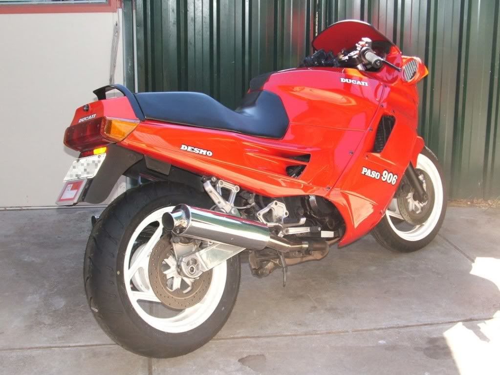

For the grand total of $5.18 and a can of bourbon and coke, (plus the cost of the tyre), modified the bike, and fitted brand spanking new rubber today, a Dunlop elite, 180/60-16
It will be interesting to see how it handles. Can't be any worse than that ten year old block of bald nylon it replaced.

you will have to offset your chain to fit the rear, and raise your front guard to fit the front.
I bought the Dunlop rather than the Avon because it was cheaper, and as this is a bit of an experiment, I didn't want to invest more than I had to.

A few things to be aware of with the fitment of these tyres...
The bigger tyres are somewhat taller, the sidestand will become very short. the centerstand will no longer touch the ground.
If your rear axle (adjustment) is not past the 6 o'clock position the chain will not be long enough to fit the new tyre in the swingarm.
An old sprocket center (as a spacer) will offset your sprocket by 8mm. You will need five "low head socket cap screws M8x40" (for the heads to clear the swingarm).
Turning your drive sprocket over will offset it by 10mm, so use a second faceplate as a (2mm) spacer... (grind the spline tines out of the center of the one you are using as a spacer) to bring the offset back to 8mm.
To raise the front guard, put (6mm?) spacers between the brace plate and the mounting lugs on the forks.

I went for a ride today. It was the first real opportunity I have had to do a good spirited and proper appraisal of the tyre.
I checked my chain last night and found the sprocket bolts had came loose, despite the fact I had used Nylock nuts on them, after only 250 k’s. This could have been caused by a number of factors, but I put it down to not being able to supply enough torque through a 5 mm Allen key to tighten the sprocket correctly. So last night, I ditched the spacer setup, and went with the normal chain and sprocket layout. This left a 2mm (chain/ tyre) overlap.
This morning I gently cut in the tyre (it took about 60 k’s to cut a decent groove). Then headed for the hills.
The weather a warm 29 degrees, the roads were in excellent condition, clean and grippy.
The tyre Dunlop Elite 180.60/16 (rear)
I was impressed with the level of traction the tyre offered most of the time, it felt surefooted under acceleration (I couldn’t get it to break traction). Could only be described as confidence inspiring mid corner, it was as steady as a rock, and handled everything I threw at it, even with a bit of dampness on the apexes around the top of the hills. And the bike now has more mid corner ground clearance.
However, this tyre was designed for a much heavier bike, and under brakes was a different story. The tyre offered very little grip under braking. Once the weight was offloaded, it would lock quite easily and skid, (I think it’s called perimeter traction). The back end can come around quite quickly in an emergency braking procedure. And getting ambitious on the down change, into bumpy corners does tend to unsettle it a bit. It’s not anything too horrifying, but it is something to be aware of.
