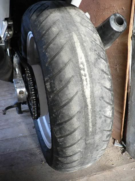

As mentioned in another topic, I have fitted a D250 to my 906. The tyre had been removed for the rim to be repainted, but it is now remounted so I am able to post pictures and measurements.
Please note: I am not saying this is the best option, but I chose to fit a 180/60 as I couldn't get the correct tyre. I chose the Dunlop as I intended to fit a Dunlop front and wanted the same manufacturer front and rear.
Oh, and before I'm asked how it performs against the original Michelin, this is the Metzeler 160/70 that was fitted when I purchased the 906 - and it is the only Paso I have ridden.

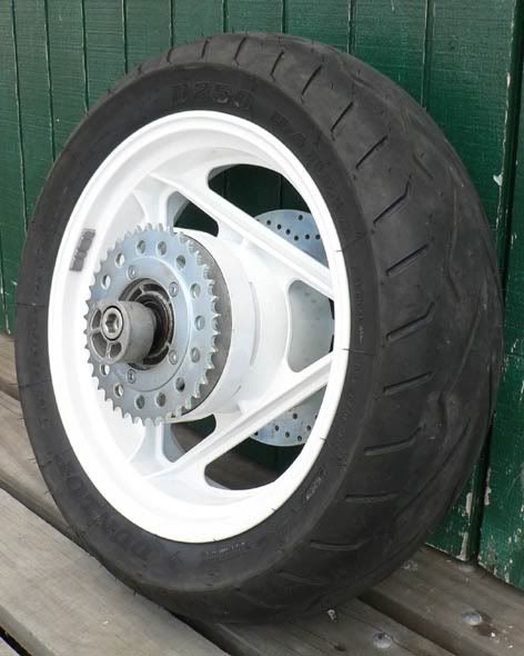

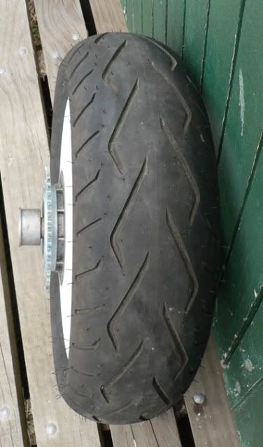

Ok, so here is the D250 fitted to the 906 rim
The maximum width of the tyre is 183mm, and height is 615mm.

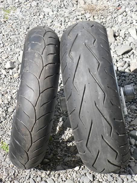

Here it is with the Dunlop 130/70ZR 16 Sportmax Qualifier - both viewed from the rear.

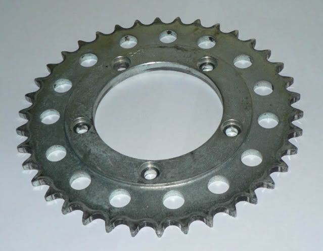

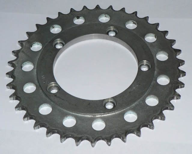

The rear sprocket had to be offset the same amount ofcourse. I bored the centre of the sprocket oversize by 4mm (diameter) and made a 10mm thick spacer with the original hole size (90mm) and a spigot that protrudes and locates in the sprocket.
Above is the standard sprocket, and below with the centre bored out.

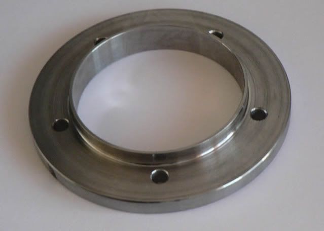

Here is the spacer I made to locate on the hub and in the bored out sprocket.
Do not just space out with washers or a plate as there will be no location for the sprocket and it will come loose. 10mm offset is the maximum you can achieve due to sprocket/swing arm clearance.

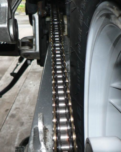

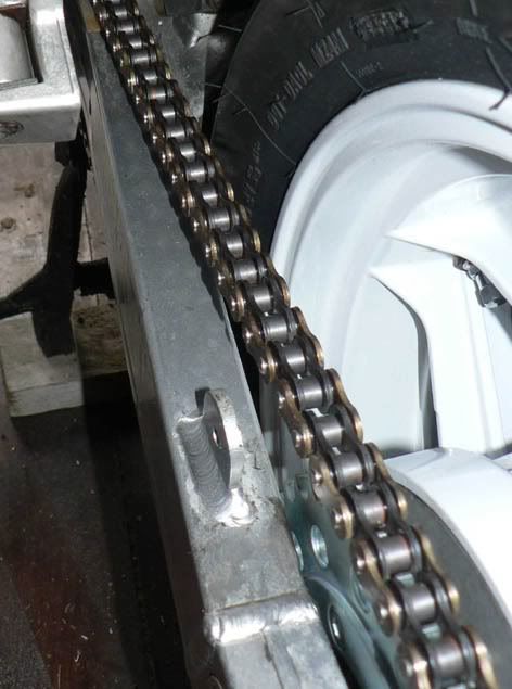

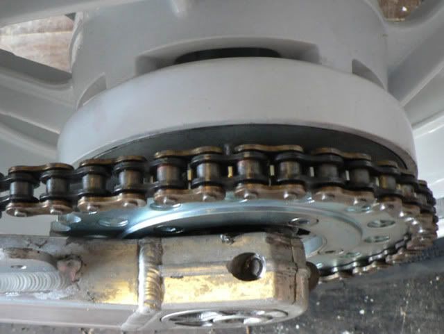

As promised here are photos of the rear wheel fitted.
Clearance between the tyre and chain is 8mm. Feel free to ask questions or request further photos. I will be posting more when the bike is fully assembled.
Can anyone supply dimensions of the original Michelin and original chain clearance please?
