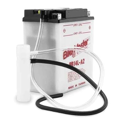

Also a spill tank is a good investment and not expensive. This is a small clear plastic container/tube that connects to the overflow hose that most batteries have on the side. This will save you from having ugly white spots on the swingarm from battery acid. All it needs are 4 small holes in the plastic (rear fender/battery holder) and you can fix it with 2 cable ties.

Also available from Bevel Heaven http://shop.bevelheaven.com/detail.aspx?ID=697

... and very easy to make such in garrage...hahahahah....
