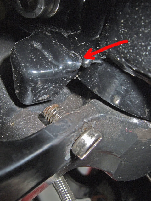

- Scratches on the mirrors, less well fitting FAR replacement mirrors or small dents in the tank from the steering or scratches on the outside of the steering halfs can indicate that the bike fell over or had a crash. Hence look closely at the steering stops on the steering tube of the frame (above the lower triple tree). Are there any cracks or are they bent ? If they are bent the steering will touch the tank when turned fully in or a longer adjustment screw was used. Check also if the outer side of the footpegs and rear brake/shift lever are scratched or bent

- Posts: 5568
Re: LOOKING TO BUY 906 - WHAT DO CHECK!
bent and cracked steering stop with new/longer screw to compensate
