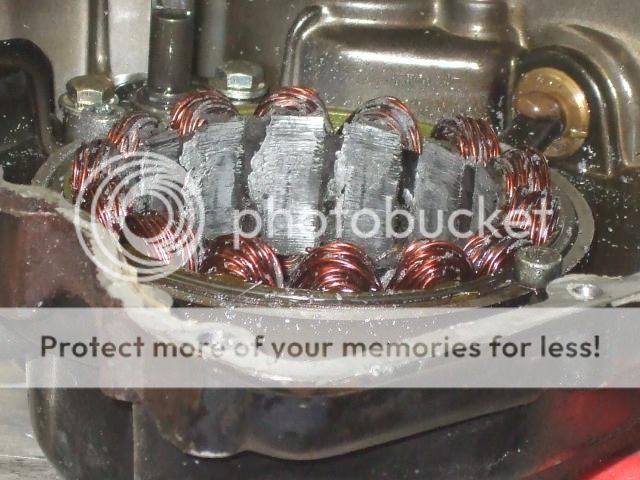

If you tighten that nut incorrectly (to tight) it can crack and explode the rotor, making it gain in circumference and welding itselt to the stator. This will lock up the engine and spread aluminum particles throughout the engine causing the need to have the motor rebuilt. $$$$
This actually happened to me, and to a few others.
There is a service bulletin to Ducati mechanics out there somewhere about this, so at certain service intervals they re-torque this nut to specs to prevent the nut from getting to tight.
du907
du907
