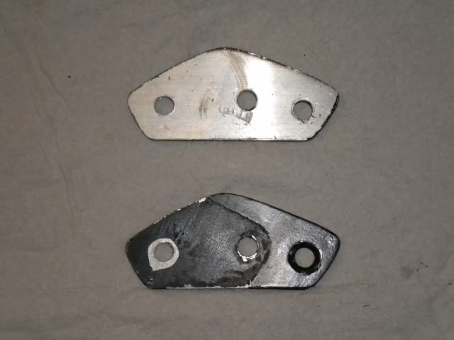

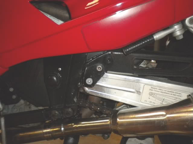

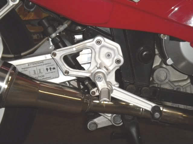

Here are the plates I made combined with the adjustable footpegs that I bought to lower and move slightly forward my footpegs. They work really well and what a difference they make in the comfortability level for my knees. As you can see, they don't look bad and you can hardly tell that anything has been done (just the countersunk bolt in the middle of the original plate). I did get another set of plates off of E-bay for a backup so that everything can be put back to original condition. No modifications where made to the original frame mounting areas. Both sides are the same with the holes bored the same.

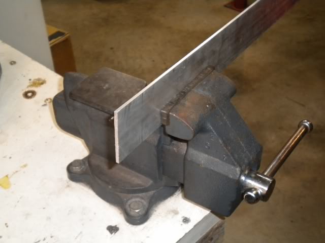

I first started with this 2" wide by 3 ft. long by 1/8" thick (50.8 mm x 914.4 mm x 3.175 mm) piece of aluminium that I found at the local big box hardware store (Lowe's).

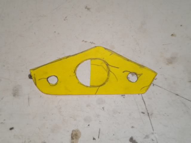

I then pressed a piece of paper up againist the frame mounting area and sketched this template.

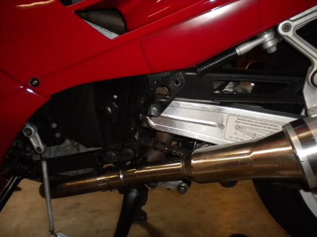

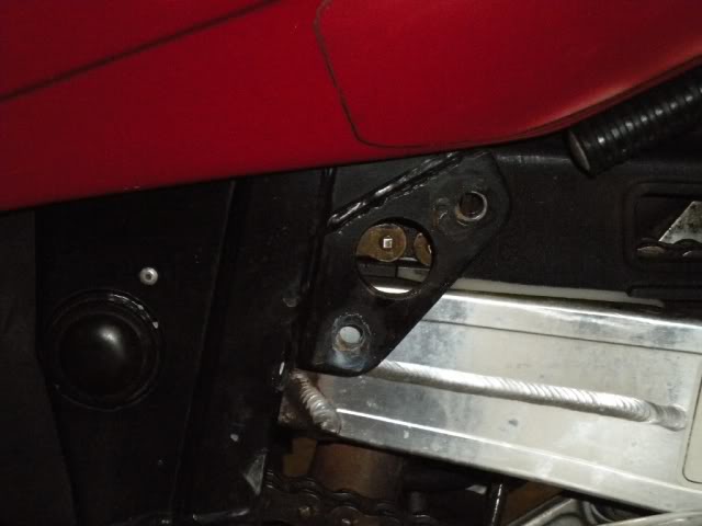

The left (gear shift) side with the factory footpeg plate removed showing the frame mounting area.
Here are the two plates that are made identical. It takes two 1/8" thick plates per side. Notice the one plate or outside plate has the one hole countersunk for the countersunk bolt that goes in the uppermost hole at the frame mounting area.

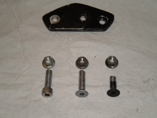

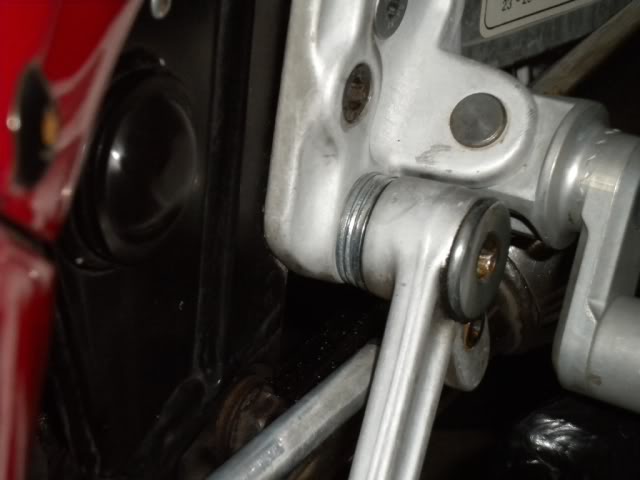

The two plates together with the bolt types that I used. All bolts are longer than the original bolts (they will pass through the original mounting area and the two 1/8" plates plus the original footpeg plates. Notice the countersunk bolts, one painted black and one painted aluminium.
My new plates positioned in place.

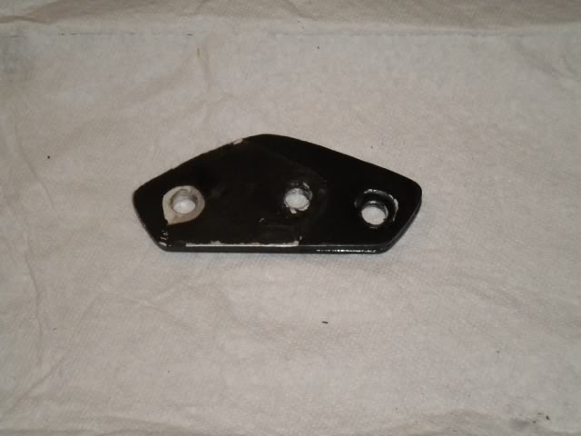

The new hole made in the original footpeg plate. The hole is countersunk for a countersunk head bolt.

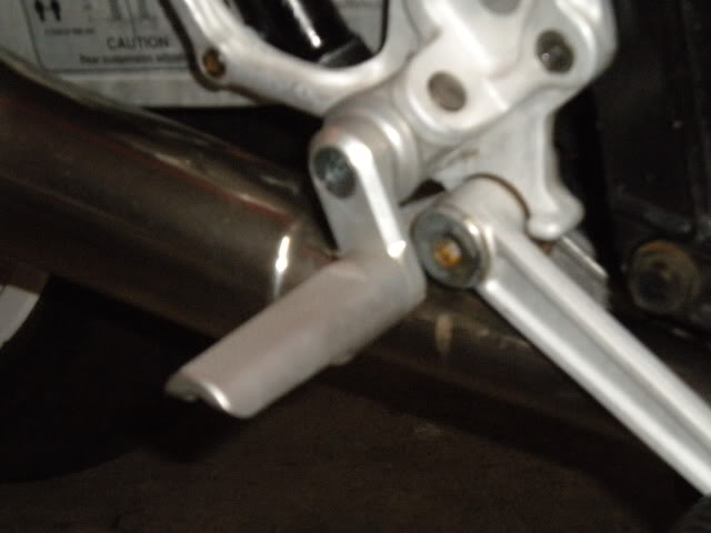

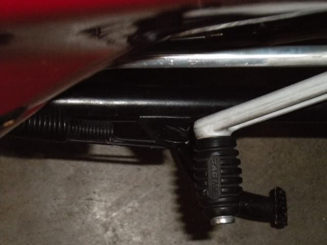

The adjustable footpegs that I bought off the web.

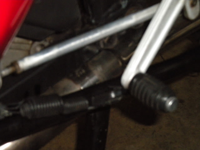

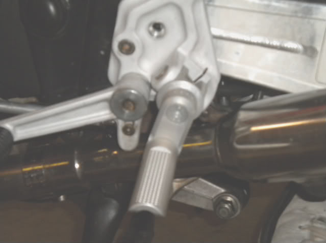

Here is the one problem area. After mounting and adjusting the gear shift lever the way I like it, the lever hits the kick stand and makes downshifts difficult.
My first adjustment was to put some washers as spacers on the gear shift bolt to move the lever out to clear the kickstand.
I'm still working on this. I may take the kick stand and cut it just behind the pivot point. Then move it in toward the engine and weld it. It won't take much of an angle to make it work

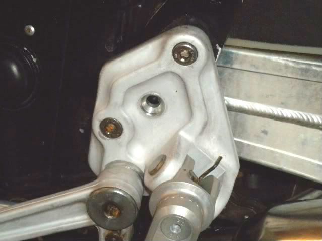

The right (brake) side footpeg. You can't tell anything has been done except for the new bolt in the middle. The lower existing bolt is just the head of the bolt glued in place so everything looks good.
The adjustable footpegs bought off the web.

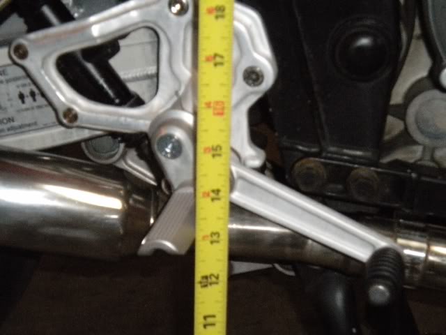

The footpegs are now slightly forward and about 13 1/4" (336.55 mm) above the ground.

Well done. I`m curious though, why did you make the mounting plates as an exact copy of the original mounting area of the frame ? If you`d made them longer on the bottom you could`ve used the lower bolt of the footpeg plate w/o having to drill a new hole in it.

The main reason I could not move the original footpeg and plate any lower was the lever linkages, especially the brake side would hit the exhaust pipes. If you will look at the brake side picture above, look at where the brake rod connects to the linkage, you will see it is just above the exhaust pipe. Luckly with my feet on the pegs my toes point down so I adjust my levers slightly lower than the footpeg itshelf. That kind of adjustment moves the rod attachment point up.
Upon reading your post again I understand what you are saying about the lower bolt hole. However, look real close and you will see the lower bolt hole lines up with the main frame tube so I would have to drill into the main tube which I did not want to do. If I move the whole plate back a little what you said could be accomplished as long as the linkages didn't hit the exhaust pipes.

When I was positioning the existing footpeg plates I tried to keep the top and front of the plates in line with the frame tube toward the rear and the larger down tube so they would look correct. Also I was moving them forward a little so that made the lower plate hole line up over the larger frame down tube. A nut wouldn't fit from behind so I cut the head off another bolt and silicone glued it into the hole in the plate. This way I think it looks "correct" and original.

1. How lower did you get w footplates mod?
2. And how much furter lower did the footpegsfrom there?

1. Footplates moved 3/4" (19.05mm) down and 7/8" (22.23mm) forward.
2. Footpegs 1.378" (35 mm) down and 1/2" (12.7mm) forward
Totals: 2.128" (54.05mm) down and 1.375" (34.93mm) forward

W the new pegs,
doesn`t it fel a bit odd to have your feet like an inch longet out from the bike?
No problemos w reaching brake lever?
