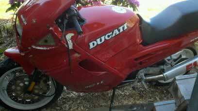

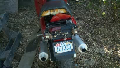

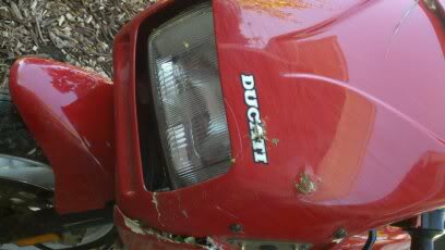

I dropped my 907 this past weekend. I was riding with some friends in the North Carolina Mountains and we stopped to take a look at the map. I took off first and left my kick stand down, leaned into a left hander and the kick stand didn't come back up and leveraged the back tire, lost control and went down hard on the pavement then into a grassy ditch. Knocked the wind out of me, broke a couple of ribs, bruised my back, inflamed the artritis in my right knee, sprained my ankle.
Dumb mistake, big Consequences.
Some pictures below.

The bike doesn`t look that bad from what can be seen. The front and side panels are glassfibre so they can be repaired. The parts for the rear also can be found. I guess the exhaust is scratched, one fork leg probably too and one pedal is bent. If that is a small dent on the tank from the turn signal switch ? Then probably one steering stop is bent or cracked. Better try carefully bending it back and using a longer bolt than welding it as right next to it sits the lower steering bearing and its seat could warp from the heat. (It may be possible to cool it when welding)
Except for the rear I`ve been there too although the cause was a different one.
For all those who modify the selfretracting sidestand and don`t believe what can happen ...

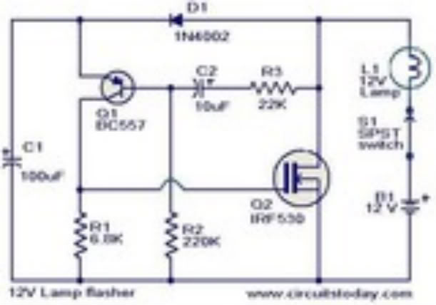

soon after I got the 907 I wired a simple micro relay and a buzzer with this simple electric circuit, and it did save the day a few times, and we all know as we get older our brain is not as sharp as it used to be...the old saying...the older I get, the better I was, is very true :lol:
the good thing about this circuit is, you can have the motor running in neutral with the stand down, but as soon as you engage a gear while the stand is down the buzzer sounds.
ps: see wiring diagram :beer: ...why do these pics came out so small sometimes??

Claude,you using photobucket?
if so you can resize the picture before you link it. Also use the preview function to check it before you submit
100x70
160x112
611x428
Keep in mind if the image is small to begin with you will have to sharpen the image or it will get fuzzy like that last one :wacko:
In most cases you will be going the other way big to small which is usually pretty easy :beer: :beer:

thats much better :thumbup:
ps: forgot to mention, due to very low current draw, these micro relays can be very small (the size of your thumb nail) so you can put them anywhere, make sure the buzzer is loud enough :beer:
