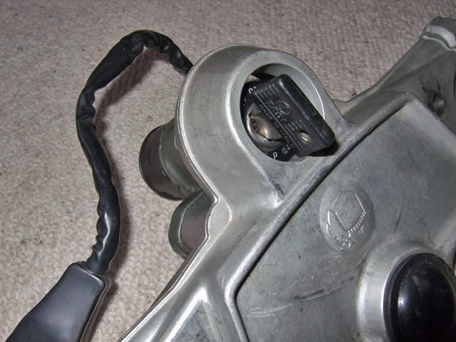

I can confirm today that distance of the mounting holes is the same on all Paso switches (there were some small washers stuck in my 907ie switch that`s why it didn`t fit correctly on the upper P750 triple tree)
The locking pin is also on the same position, so the only difference is the height of the upper barrel. That`s 39mm on the 907ie lock and 52mm on the P750/906 lock. (The connector on all is the square one with 6 round pins in it)
So if you have a 907ie you can use a P750/906 lock and it will stick out 1cm which is ok, vice versa it will work also but it will look like this
q.e.d.
q.e.d.
Re: Ignition Barrel Required?
Q.E.D. Indeed
So if I understand you correctly the picture is of a 907 switch in a 750/906 upper tree ?
Just want to be sure
yes, correct (you need small fingers to turn the key, but it works)

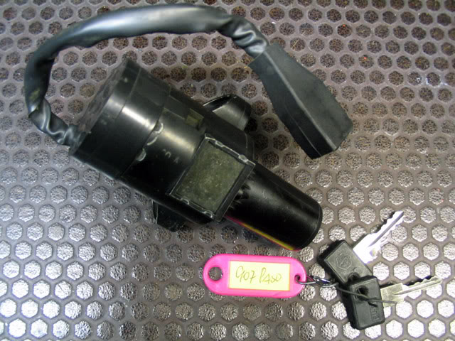

"Mr G", i send PM to You just with 4 fotos from my 907 keylock, so U can add suitables to sites...
Paso 750 -89 red/metal grey
907IE -91 red/metal grey
907IE -91 red
2xST4S -02 red/metal grey
ST2 -01 red/metal grey
907IE -91 red
here`re 2 of Antti`s pictures.
As Francesco mentioned before there seem to exist two types of switches for the 907ie (although there`s only one upper triple clamp). The short one like on my photos and the longer one which is basically the same as the one of the P750/906 with the longer barrel (this is the same one as on Higgy`s 906)
