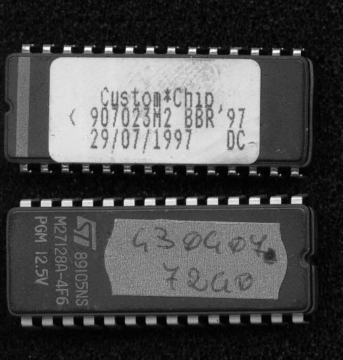

somewhere on an old harddrive i have those FIM or similar .bin files to make those chips but i just never found the time to get the right e-proms or a a e-prom "burner".....

Re: FIM quits!
It's not so hard finding and burning the eproms, but the main thing is knowing what kind of eprom is...Stingray230SX wrote:somewhere on an old harddrive i have those FIM or similar .bin files to make those chips but i just never found the time to get the right e-proms or a a e-prom "burner".....
doug
No matter, I already have two kinds of burners.

Re: FIM quits!
ok here is a pic of the eproms needed.......
and i found 2 files in my computer(1)907 custom chip and (1)907 euro chip, both of these are .obj files but when viewed in notepad seem to be hexidecimal code so i think the process was change the file extention to .bin and burn to an eprom....i got these off the net a few years ago and never did anything with them but if someone wants them let me know
doug
doug

Re: FIM quits!
As they seem to be custom chips, they are quite useless, if u dont know, what mods have done to bike(from where are those).... Anyway U can try them in bike and i quess, that nothing very bad cant happen...
better dyno bike with those and see, what is best one...

Re: FIM quits!
yea i am not sure of the programming on the custom chip......i thought i had the FIM copy but that is the picture i found and the file name of the actual .obj file matches the "custom chip" labeling so again..i am not sure but hey it might be for just slipons and/or airbox mods etc.....
but if anyone wants to play around there it is............
if i can find a couple of the blank eproms i might try to get a eprom burner/programmer and try it later....cant right now as i just bought a 1995 softtail project bike and its gonna take up most of my time/money for the next couple of months.
doug
