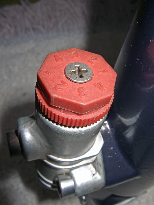

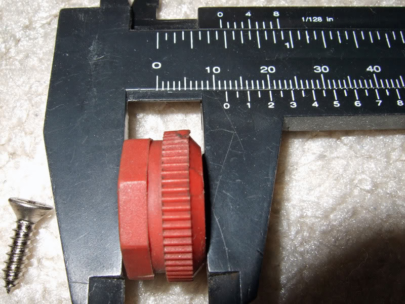

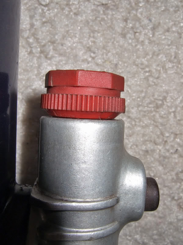

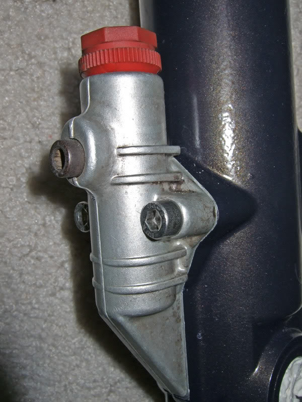

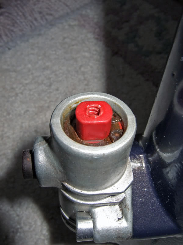

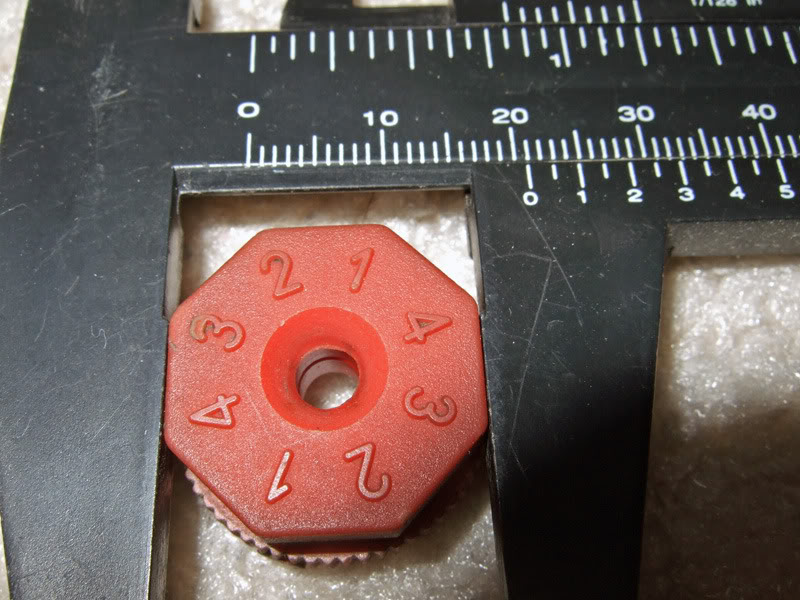

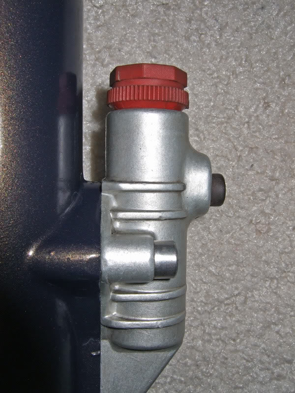

Is it possible someone could post a couple of photo's of the damper unit on the fork leg as I am now going to get mine repaired and rebuilt by a mate that I have hooked back up with who fabricated a load parts for my old Rickman Triumph Cafe Racer ( which I should never of sold
), I am interested in the top of the dial knob as mine has been sheared off so a front, side left and right and and top down wards looking photo would assist in getting an idea of the size and look. PM me if it is easier to email it direct and I will pm you back with an email address to post it too

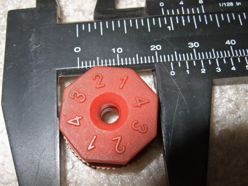

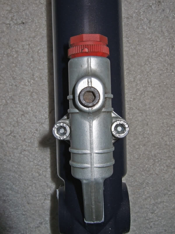

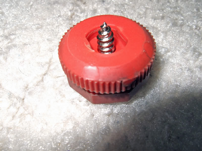

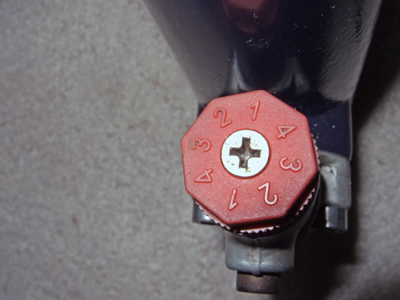

there you go. Here`re some of my spare 750 fork but the adjuster should be the same for all.
Depth of the recess on the bottomside of the knob is 4mm. (normally there`s a black rubber "tube" over the knob. That`s missing on most Pasos I`ve seen. That should probably just prevent that water enters and the circlips starts to rust)

A Big thank you to you for this
that was quick and just what I need
