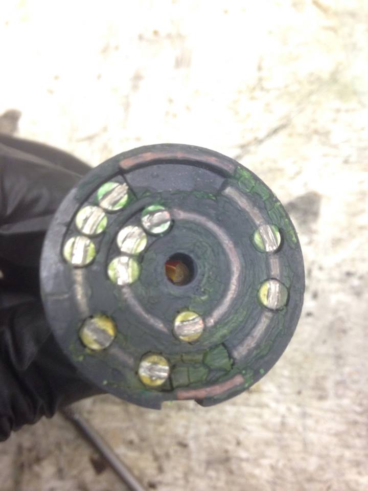

I've got an intermittent glitch in my ignition switch which occasionally kills the power. Usually when I hit a bump at low speed. Jiggling the key remakes the connection & we're off again.
I'd like to strip & clean the switch before it gets any worse.
Can anyone tell me if it is easy to separate the electrical switch part from the mechanical lock part without doing irreversible harm to either ?
Ignition Switch Strip

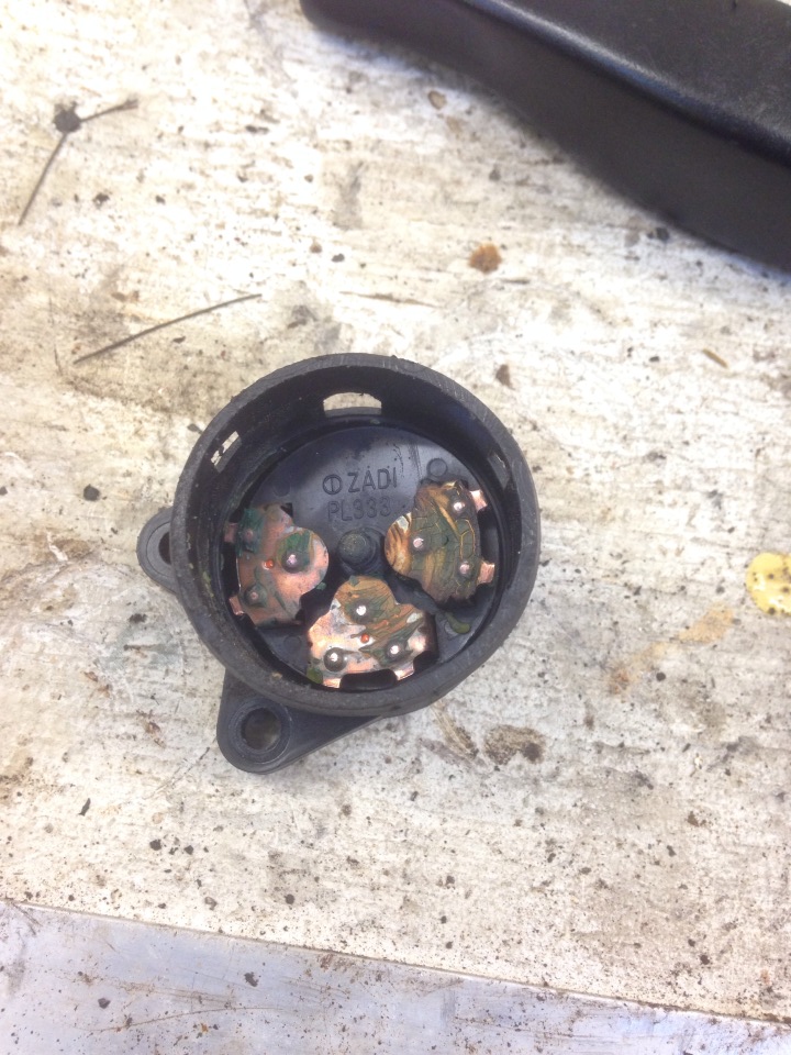

Took my ignition switch to bits & you can see what it was like inside.
All cleaned up & switching away happily now.
