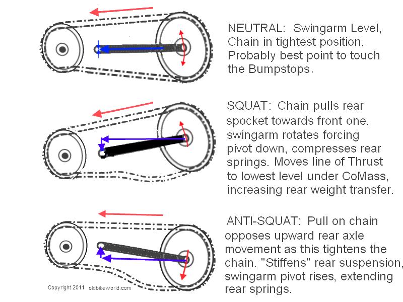

For those who like reading and haven't switched off yet, here is a good explanation and diagram from a website which is no longer active with regards to Squat.
THE REAR END FIRST or I Don't know Squat!
The entire geometry of a motorcycle can be based around the rear axle position.(please, just go with me on this)
If we consider this point to be 'fixed' then all other movements of the bike & suspension that occur during riding or any modification we make actually pivot around the rear axle, or move in relation to it. ( You could use the swing arm pivot point, but I think the back axle is a lot easier.)
Because of this, I will commence the design & build from here.
One of the most critical elements to good handling and getting power to the ground is the amount "squat/anti-squat" built into the bike.
The effect of "squat" is often misunderstood as it is a bit counter-intuitive. If we watch a powerful bike, or an old style muscle car, take off and accelerate hard from a standing start, we often see the rear end dip or "squat" down. This looks great, the rear tyres are obviously being "planted" into the road, increasing traction…. SORRY…WRONG!.
There are a number of things happening to cause the squat, but the end result is the tyre being lifted up towards the vehicle and away from the road. Result: Less traction and drive.
For a Motorcycle, three things that are occurring are:
Rotation of the bike around the rear axle, due to traction.
(imagine taking off with the back wheel bolted to the road)
Lifting the front end, transferring weight to the rear, and compressing the rear springs. SQUAT!
Secondly, the chain is pulling the top of the rear sprocket in a line from the top of the front sprocket. This pull wants to shorten the distance between the sprockets, the only practical way for this to occur is by rotation of the swing-arm. If the configuration of sprockets and the angle of the swingarm is such that rotation will shorten the distance, then the swingarm pivot will be pushed down towards the ground, once again compressing the rear springs. SQUAT!! (see drawing below)
