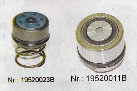

We checked the numbers today. For the Paso, 750SS etc there`s either the whole set (incl. bearings etc) or the bearings, O-ring a.s.o. as a single part. But not the single piston. This is only part of the (expensive) set. For the 900SS it is available as a single part and costs - tada - €25 ($45 in the US). Use it with its V type rubber ring, don`t use the old O-ring for it.
The history of the parts program showed that the ordering number changed so there`re 3 numbers.
The one mentioned before (195.2.002.1B), one ending with 3B instead of 1B and the latest 19590023B.
Sorry for this little mix-up. We changed this piston about 2,5 years ago or so.
remember to remove the blue seal, put in a bearing (SKF 608-ZZ) instead and use your old mushroom pin (not sure if you have to switch the spring with the old one from your bike, but I would as the part number of the spring is not the same). The bearing btw is commonly used for inline skates or skateboards so you may find it also in a sports shop.
PS: there is also a repair set for the early 750SS/900SS with dry clutch and secondary piston (26mm) in the clutch cover. Its number is 19520011B and it costs € 118/$175. It is the replacement for 19520011A & 037016460. 037016460 was the part number of the P750 clutch piston. This repair set is the complete piston with seal, bearing and pin (below right).
If you need the piston only or don`t see the point why to spend 3,5x as much get the 19590023B + new bearing (approx. $3-5) and use your old spring and mushroom pin. (even if you have to get a new bronze pin machined by a shop it will be the cheaper option)

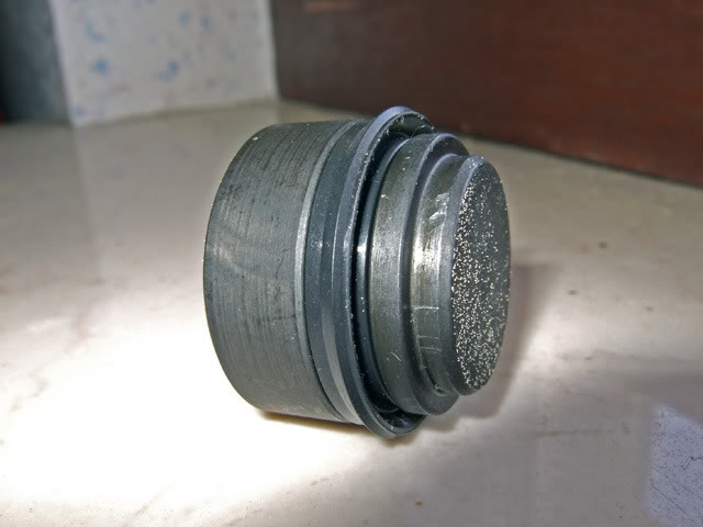

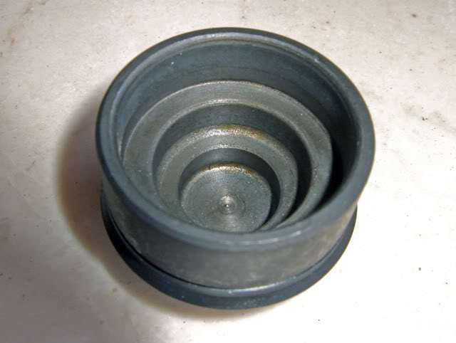

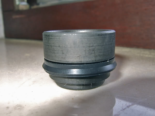

I did this just a year ago, so you'd think I'd remember what I did... But I don't. How to get that stupid blue seal out of the slave? I've already poked myself good once; I figured I better ask someone who knows better before I need stitches.

Jake, the blue oil seal should just lever out. If there`s no seal/o-ring on the piston you can try to heat the piston up a bit and then lever the blue seal out. Otherwise just drive a sharp screw into the blue seal and pull it out. The problem then will be how to hold the piston

That's what I thought I did last time, but this one was giving me fits. I was kind of anxious about marring the surfaces on the piston to, so I wasn't using grips or a vice or anything - just trying to hold it in one hand.paso750 wrote:Jake, the blue oil seal should just lever out. If there`s no seal/o-ring on the piston you can try to heat the piston up a bit and then lever the blue seal out. Otherwise just drive a sharp screw into the blue seal and pull it out. The problem then will be how to hold the piston
Ok, so just perseverance & brute force? I have those.
