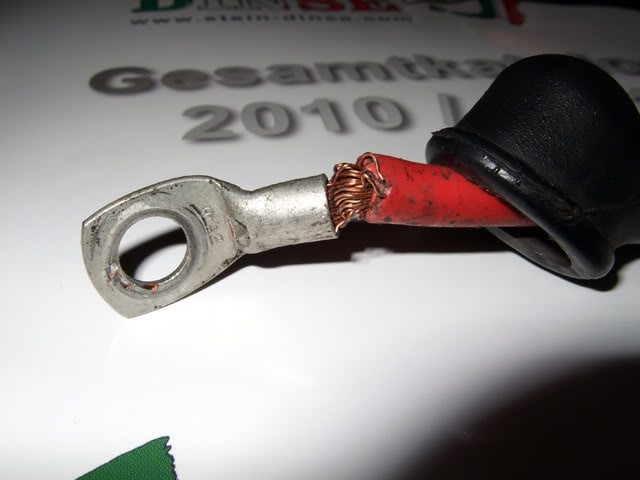

None that I saw. I'm very much a DIY type person and was just pointing out the limitations to going DIY on some aspects of the bike.paso750 wrote: I didn`t mean to criticize btw if that is how my comments were understood.
Even with my professional crimpers for other types of terminals it is possible to get a "looks good" crimp that is not a good termination. Even the ratcheting crimpers have to be calibrated for each crimp before they get them right.

Proper crimping is the key with any connector, and bigger connectors are more difficult/prone to problems. Putting some dielectric grease on those also helps that the connection doesn't degrade over time.
If you have a cable that is a bit sluggish, cut through the crimp and take a look at how ugly it can be inside. A little bit of water and time will kill it. If it wasn't crimped tight originally, water will creep in and degrade everything. Just putting on a new connector often helps, but you have to clean a new section of cable, and it may not be long enough anymore.
I too did the Powerlet upgrade on my ST2, and later my ST4s. Good improvement.

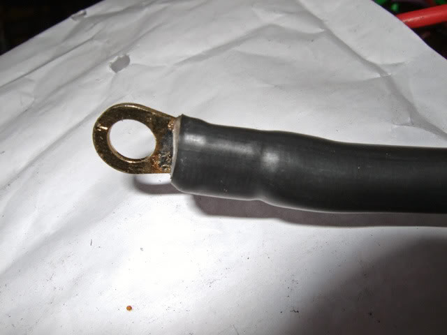

Will soldering the crimps be an advantage?
Re: New cure for hard to start Paso bikes
Which type of grease would be better to use,dielectric or conductive?
I usually solder the ends after crimping. That will fill the smallest gap and grant contact in the full section. Be aware though the brazing solder should not creep in the cable behind the connector as it will become stiff and with vibration that`s usually the point where it breaks.
Dielectic and conductive grease are two different things. Conductive is for contacts/contact surfaces to improve flow of electrical current, dielectic to protect contacts after they`ve been assembled. It seals from moisture. So clean all contact areas and use dielectic grease after you have connected everything. I personally never did but theoretically you can use both.
Mentioning sealing from moisture - it`s important to overlap connector and cable with heat shrinking tube.

Long story short,yes and no The reason multi strand wire is generally preferred is due to its physical properties rather than its electrical properties.Multi strand wires stays cooler,are better able to flex and in general last longer connection wise than single strand wire when properly terminated. Multi strand wires are less rugged and more prone to corrosion than single core wire. Single core wire also tends to expand and contract more than stranded core making positive termination more trouble prone over time requiring more frequent maintainance.Does the current carrying capacity of the same gauge wire vary with the no of strands, void space, manufacturing type, manufactuer?
Electrically speaking there is very little difference aside from wire gauge in the properties of multi strand versus single core when the material used is the same. Electricity tends to travel along the outer surface of any wire and multi core wire for all intents and purposes acts like a single core wire gauge for gauge. jm2c
