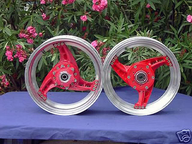

if converting and the bike is red I would take the wheels of a Bimota Furano. I think they are amongst the nicest wheels, look a bit like the Marvics and should match the bikes design better than i.e. Marchesini wheels. (once in a while a set shows up on ebay)

those are beautiful. that would definitely be an acceptable solution keeping with the design theme of the bike.
