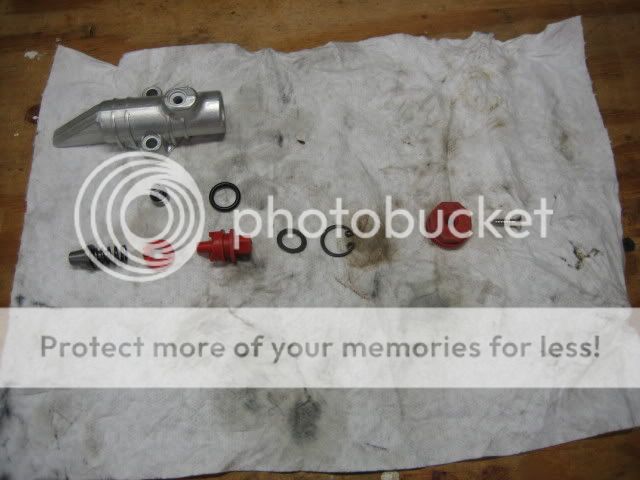

This is what the guts of your fork damper adjuster looks like:
Do you see the black o-ring in the photo? That's the culprit. It goes into the groove of the red component pictured immediately below it and it seals the oil in. My forks had not ever been apart under my ownership (14 years) and there was a lot of filth on all of the fork internals but my damper didn't leak; I just took everything apart when I replaced the fork seals and dust wipers and thoroughly cleaned everything, including this damper. NAPA auto stores should have a metric o-ring replacement for this.
As for the fork seals themselves, you can order exact duplicates (even made by same company as the Ducati part) from Parts Unlimited. Their part number is 0407-0128 and their size is 41.7 mm x 55 mm x 10/10.5 mm. Will run you about $8-10. Dust wipers are still available from Ducati, part number 000048396. They were about $30 I think.
If your mechanically inclined, you can do this whole job yourself. Good luck!
