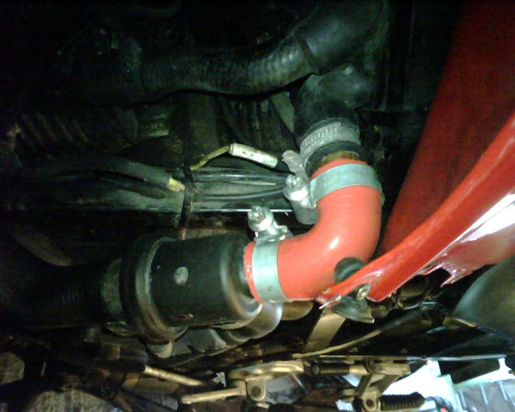

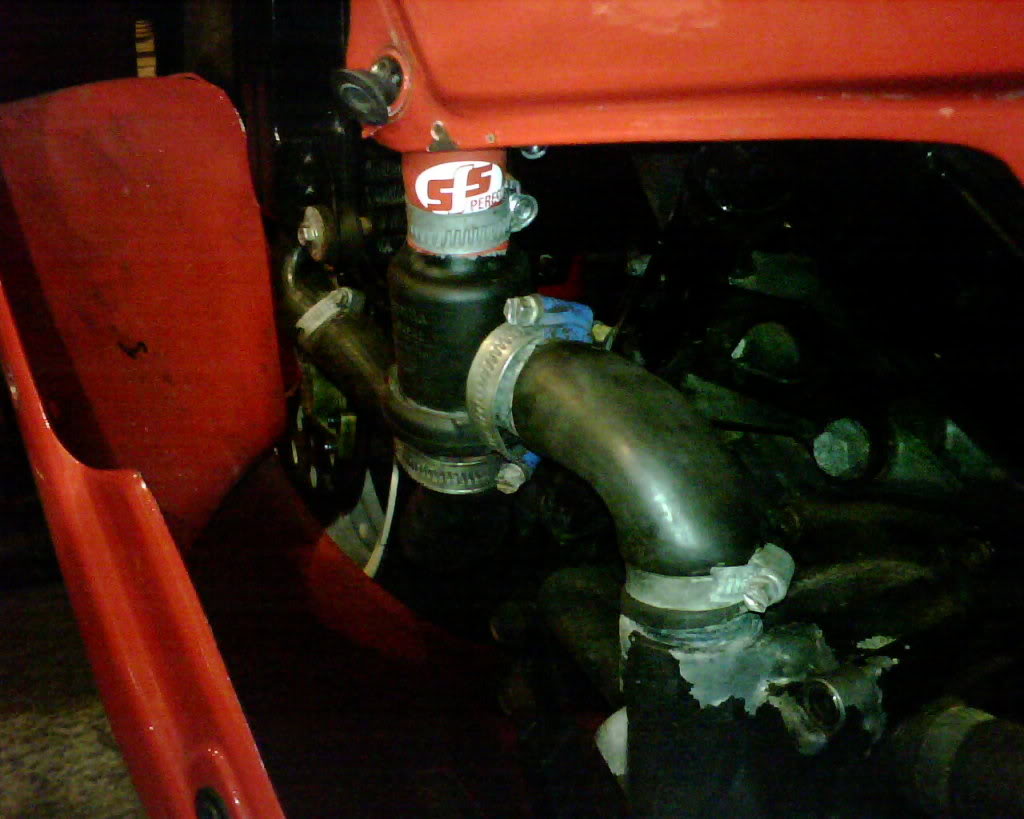

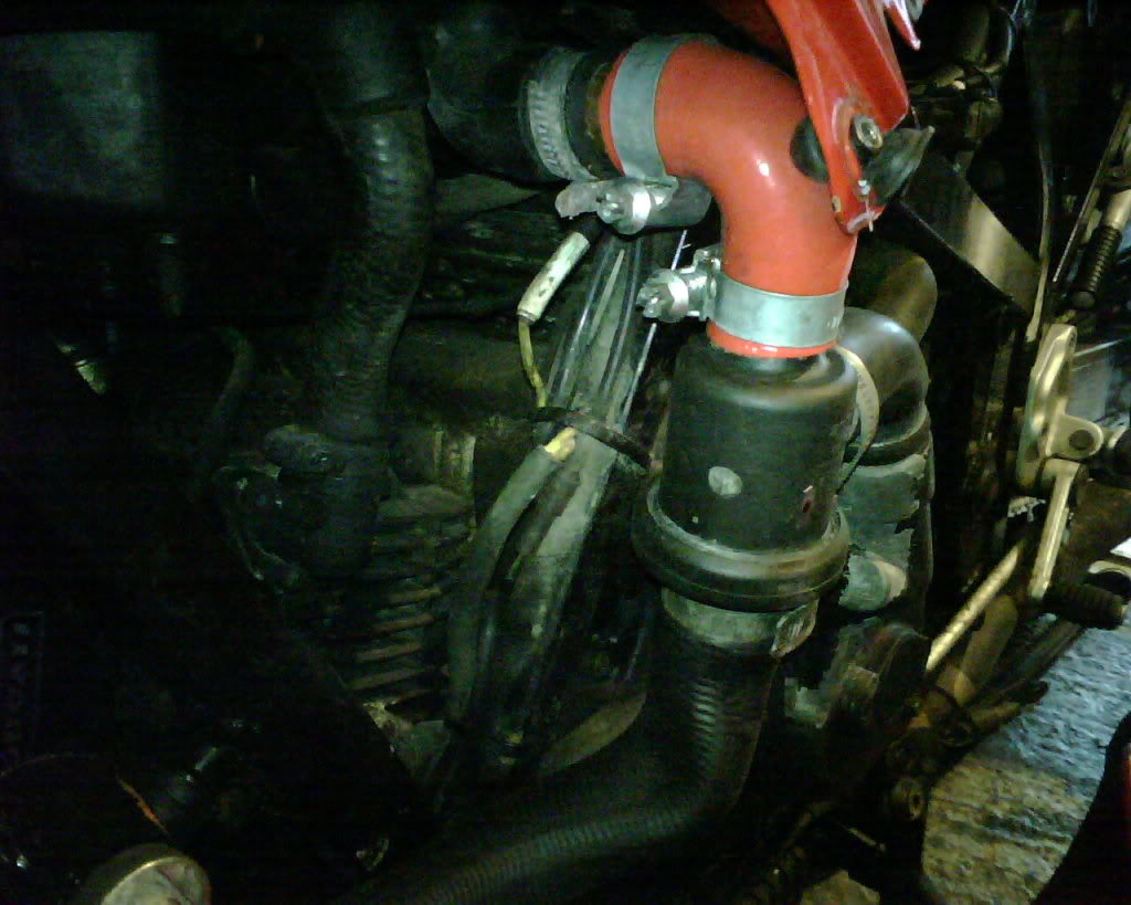

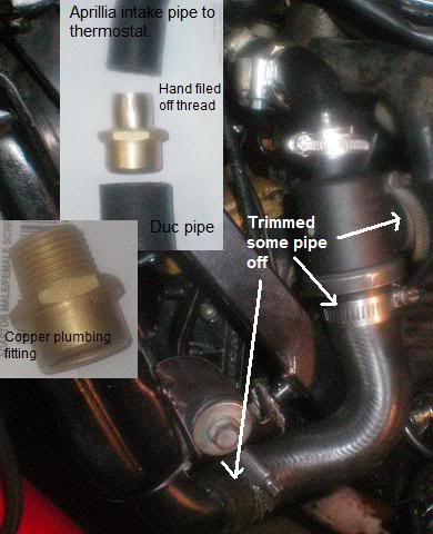

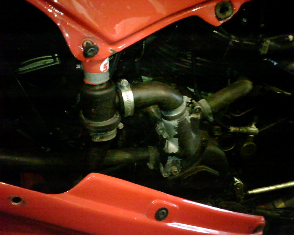

Pictures of the Aprillia 1000 thermostat as fitted to my 907ie
You can see that there is a slight kink in the outlet to the radiator, but I guess when the system pressurises when hot it is OK bacause the system runs a steady 80 centigrade out in the countryside at speed, and a steady 88 in town traffic with the fan cutting in and out as normal
I have not had to cut any of the original hoses. I have cut down the 90 degree red silicone bend (19mm/ 3/4" bore), and I have used a 22mm copper tube (about 75mm long) to link the silicone bend to the original coolant tube. I really need to replace this with something better, but it works for the moment without leaks.
Hope this helps someone
Sean

The reason I used the flexible hose bend is because the outlet from the thermostat is 15mm, and the inlet to the top junction hose is about 25mm. The bend is 19mm. Squeezing the jubilee clips got a seal on either end with a 22mm copper pipe.
Not sure about connecting metal directly to plastic. Would either have to thread if the bend had sufficient wall thickness (not sure that the thermostat outlet would have), or use an industrial glue.
Either solution may not withstand the environment of thermal cycling, pressure changes and vibration in the longer term.
A solution is to use the Samco bend as I have done to connect to the thermostat, but then to replace the junction hose with silicone as well. I did buy a T piece for this purpose, but need to get the rest of the hosing. This would then pull in the thermostat so that it looks more natural.
