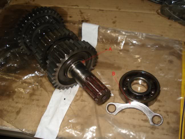

This has finally got the better of me,so I stripped the engine down this week to find out what is wrong.
Turns out there is a shim washer missing from between the shoulder on the shaft and the bearing,"A".
That was allowing the 2nd gear to rub on the bearing retainer,"B",fortunately it has not warn it greatly.
According to the 906 parts catalogue the part number is 067016171.Does anybody know weather these are
still available,if not,has someone got a spare they don't need.
