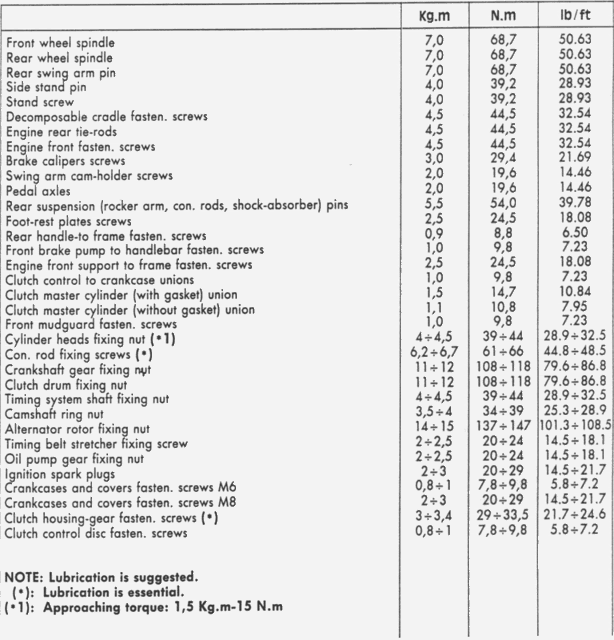

installing a new clutch [MPL slipper] and I can't find a torque setting for the clutch springs bolts.
Is there a torque setting, or just do them up tight?

all manuals just say to tighten them in criss-cross sequence w/o mentioning any torque spec.
- du907
- Posts: 346
Re: clutch pressure plate spring Torque?
It is not very much. About 5 to 7 ft lbs. See the settings below. Clutch control discs.
