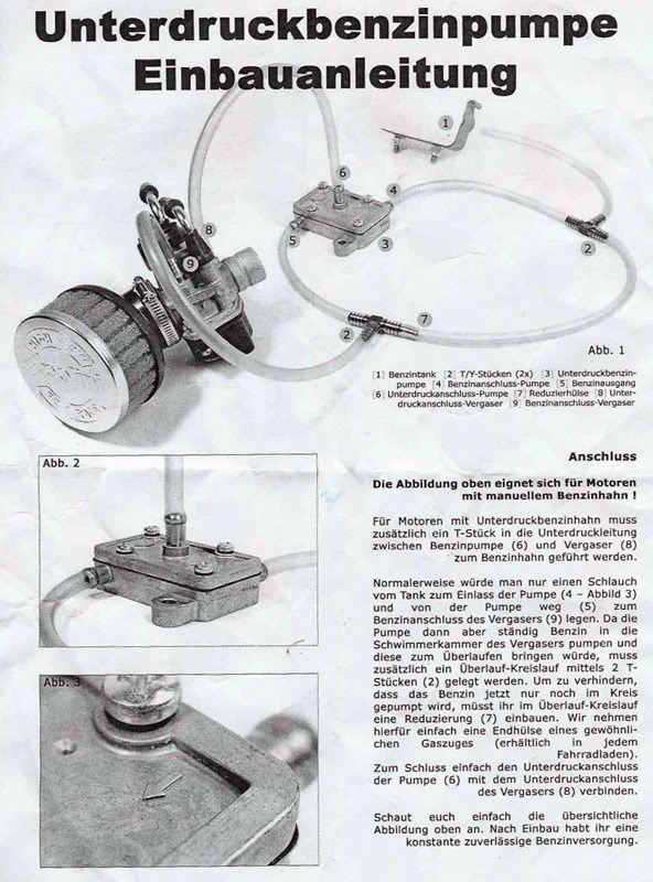

the correct name is I guess a diaphragm fuelpump.
basic setup (7 is a reducing bush, 2 is not required if the tank has a return line)

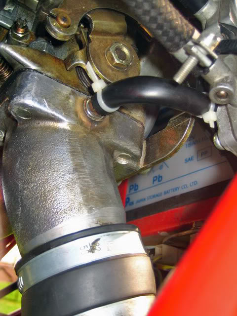

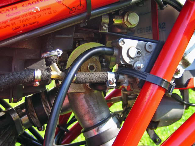

I found the webpage ( http://www.8ung.at/manxman/ ). The guy used one from an old Yamaha TDM850 (Duc Monster also use them). He used one of the connections for the sync tester on the side of the inlet manifold and put in a screwing nipple he connected the fuel pump to. (actually he used a M4 thread rod, drilled it though and glued a nut onto it). He says that the pulsatory suction process moves the diaphragm and delivers the fuel evenly independend of rpm which corresponds to what higgy had said. So I guess I was wrong again. Still worth a try though.
