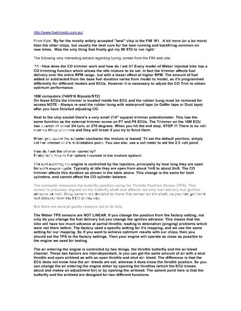

I was looking for this information and finally found it. It's from the FIM Ultimap site that has be taken off the web.
It describes how to reset the TPS and balance the throttle bodies and everything else. I have done this procedure and it is time consuming but it does work.
The adjusting of the TPS a little this way or that will set the base lean or rich and all the adjustments that follow will be based on that. In other words, set the TPS to rich and how much adjustment is left to lean it out with the other steps will be affected, set to lean and you may not be able to adjust to a rich enough setting.

Can we please get that 'fuel in moto' info on a pdf??
OK 'edit'
I saved each picture and printed them out, a bit blurry, [its 9am so no I haven't been on the piss!], but readable. Interesting, looks like a job that needs more $$ spent on tools than what it would cost to get done several times by a competent dealer.
