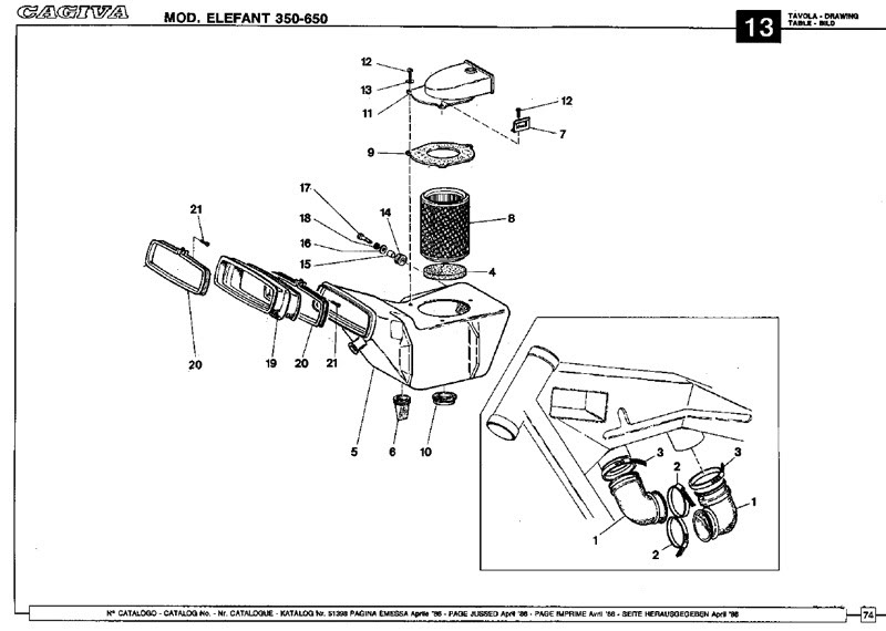

Re: elefant's 36 dellortos direct swap for weber?
Joep,
Can you post a picture of the Elephants elbows and air cleaner. I'm always trying to get a bigger air box on the Sport with the Dells. Since the Elephant came stock with it, I think it might be the best option, or at least worth copying.
Thanks for the picture. As I understand it, the air box is under the seat, so I guess I can't apply this to the Sport, but good to understand how it works.

Hi,
From the top of my head the elbows have a diameter of 60 mm on the side where you want to mount a cone-filter.
