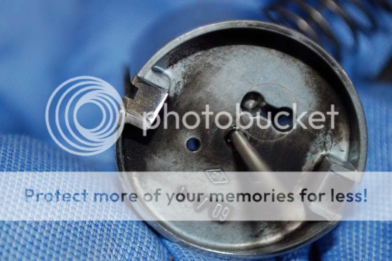

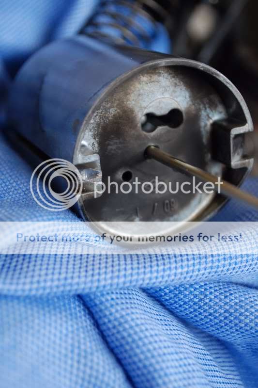

Taking the slides off the carbs revealed a whopping dent in both the slides.
Out came the files and after a while the slides were smooth again:

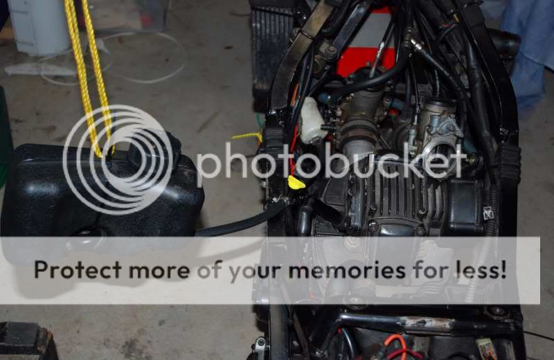

With the slides back in the carbs I rigged up the fuel tank I put together today. I went to a local lawn mower shop and got a second-hand tank with some fuel hose and a valve. It works great and I was pretty pleased with this setup.
Now it was time for Skin's "Ducati Cuddle". Followed all the steps and Hey Presto! Idling nicely at 1000 revs. :thumbup: I'll take the bike for a ride tomorrow. The weather forecast is not too great, but summer is not far away in the Southern hemisphere!
