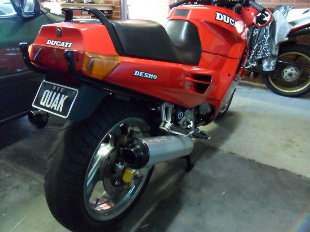

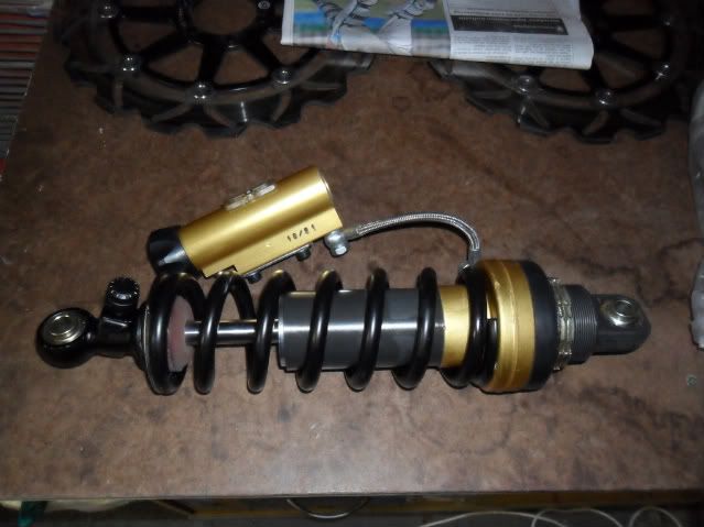

Hi guys, just thought someone may be interested in what i fitted to my 907ie.
The standard shock was rebuilt but the rebound faded out after a short period which was the original problem. I was warned that rebuilds on these are not always successful.
I purchased a new rear shock (marzocchi) from ebay for a 750/906. Prior to buying it i asked for the dimensions and compaired it to my original.
The hole centers were the same so i thought i`d give it a try on the 907. Here are some pitures.

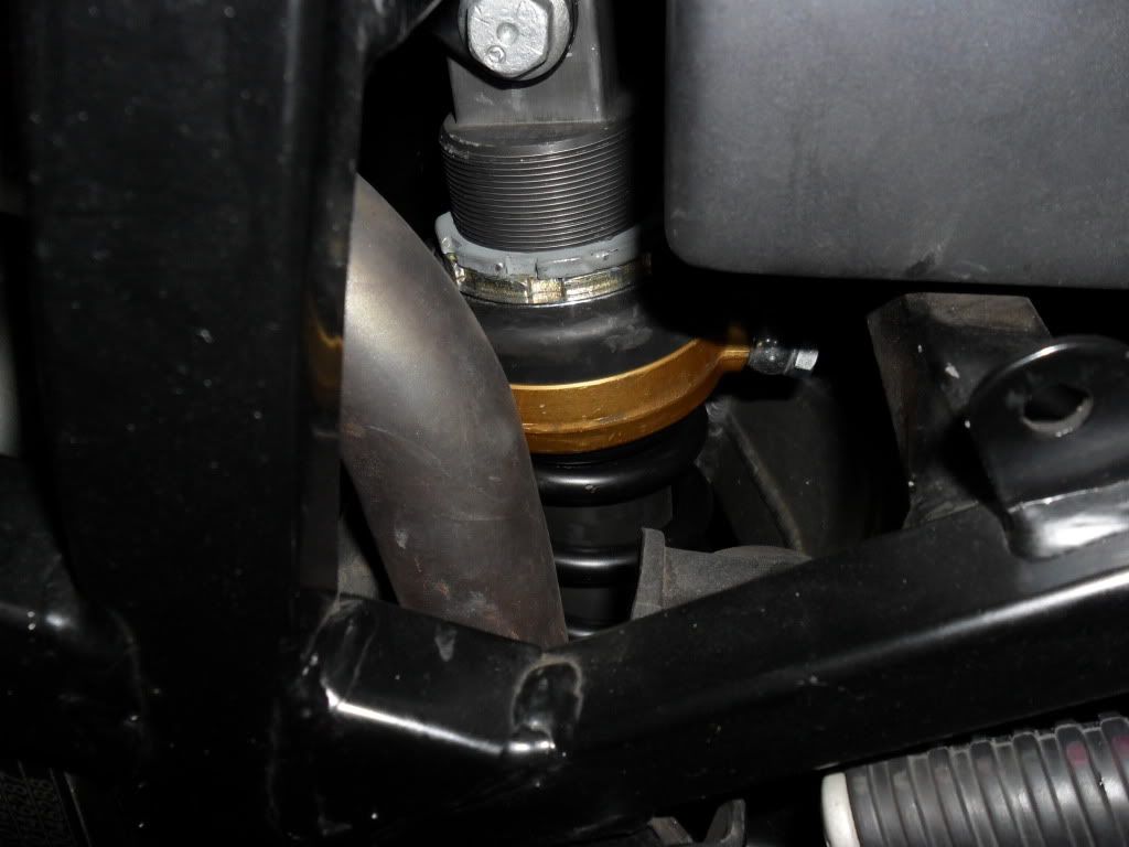

I had to wind the preload down about 10mm using the lock nuts to set the ride height after i noticed the tyre had rubbed a bit on the plastic under guard with a pillion, that was with the extra preload wound up from the remote adjuster as well (backed right off when solo though).
The shock fells good now i think i have it sorted out. It doesn`t have compression damping only rebound at the base.

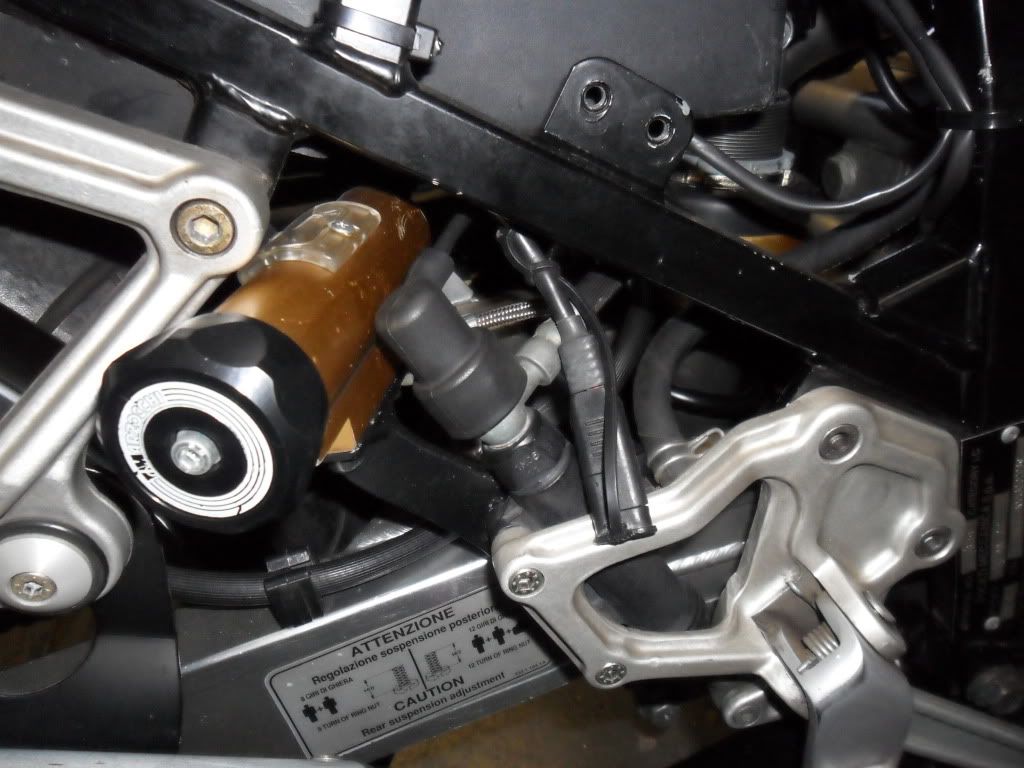

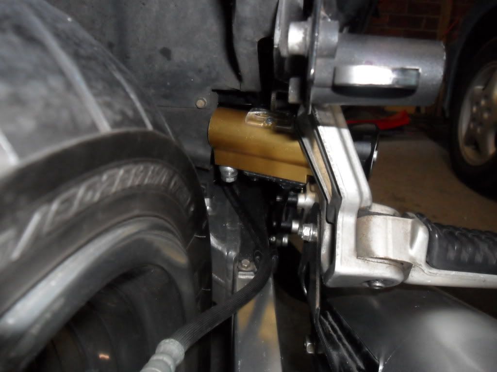

Nice...how hard was it making up a bracket for the preload adjuster? It didn't just bolt on, did it?

that seems the old marzocchi unit fitted on the PASO 750.
I got one of those, it is basically the same as the 907 one (overall dimentions), the only big difference is that the spring is different, the 907 one is 2 times harder; then the internal setup will match the harder spring, however I was told it could work also as it is.

I have one of these shocks on my bike. It works the way it should however I do think the sping is a little soft as there is a lot of contact of the rear tyre on the underside of the computer box. I have had to patch the hole once but wear continues even though I have increased the preload on the spring. (Perhaps I am a little heavier that I would really like to be too. :roll: :roll: )
I have heard others writing about that issue here and think I will be returning to the original shock once I get my new swingarm.

Hi, yes i agree the spring may be a bit soft. It doesn`t seem to be an issue solo though. I will be trying source a harder one i think. The original spring won`t fit as it is shorter.
The Bracket i made for the remote adjuster was fitted using the 2 bolts holding the rear brake master cylinder.
I paid roughly $150AU for it.
