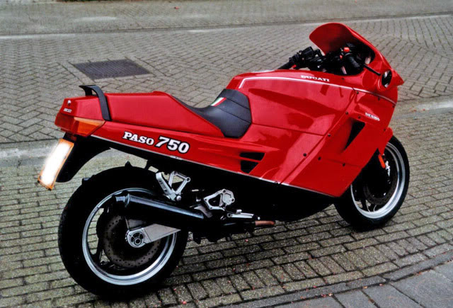

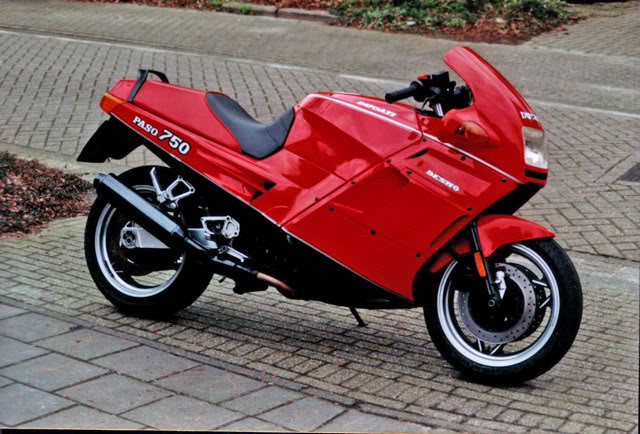

this was a friends Paso with a second skin seat cover (before its unexpected cold deformation)

That seat cover looks nice. Just like mine with the Red/White/Green on the front of the seat. Only all black the rest of the way around. The foam grips I never really was a fan of, so I am going to make a nice small order for the Ducati this weekend. Grips, a nice new heavy duty cover, plugs, oil filters, and some cleaning products. Can't wait for the warm weather to finally come!
