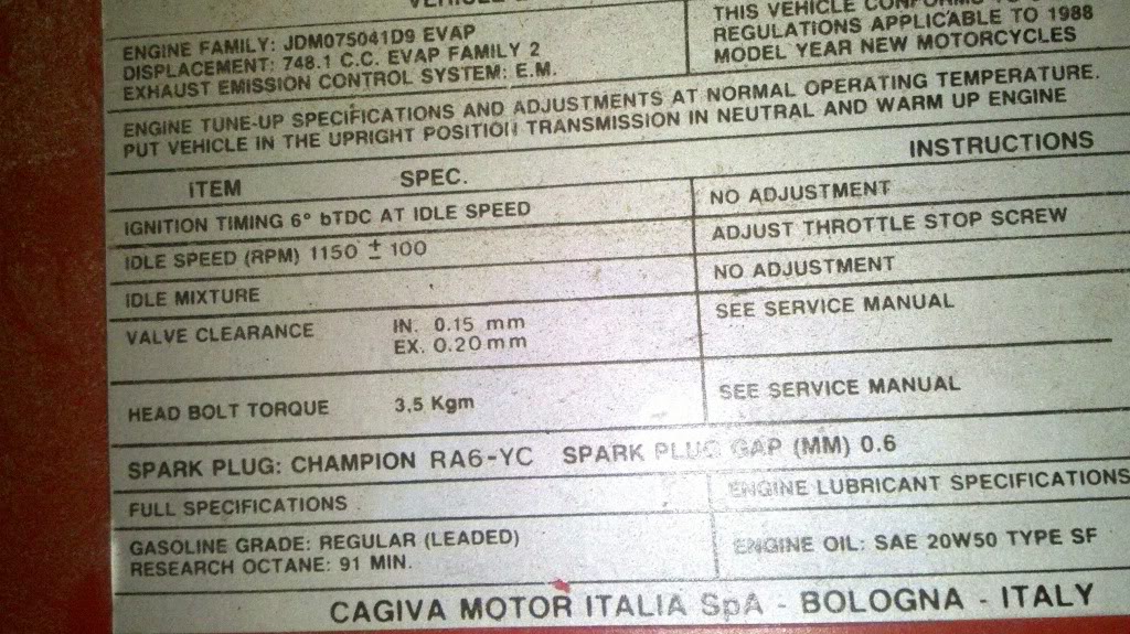

I tired to post earlier but this photo wouldn't upload. i am sorry if pictures of purple rocks plus fish and rings appear. I made a new album for the one picture I want you to see. But the other stuff shows up. If you want the green and red diamond ring let me know. It still for sale. The picture you are supposed to see is the plaque on the inside rear left panel.

But I went to the garage being mad at all this major stuff. I got my mind off of this and worked on my bike. I changed the timing belts and put the timing back in place. I shimmed the valve clearance too. I did npot have to adjust the valves thinking that almost nothing was good. I saw the plaque. Going into this project the video and reading I did said .002 was great. the plaque said that's the worst. The best was .0015? opps. I have at most .001 clearance thinking that's even better?
Yeah I dont know. My dots now line up. I heard the dots are as much as 8 degrees off?? Looking at the picture of the plaquard it clearly states that it is 6 degrees off. Nope! it says it right there. So I feel better now.
