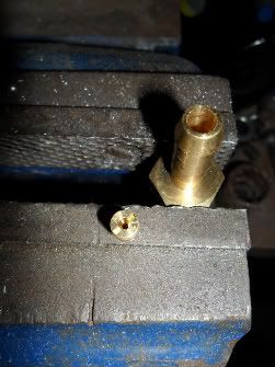

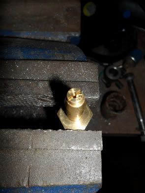

Fitted one-way breather valves to the carbs & made a re-stricter for the fuel return line... running alot better
