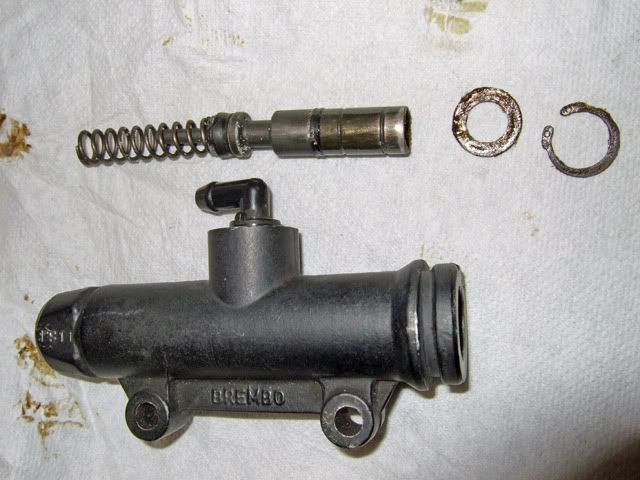

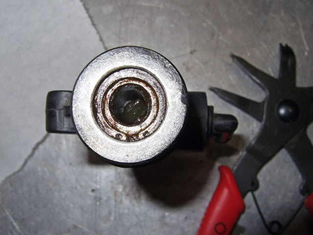

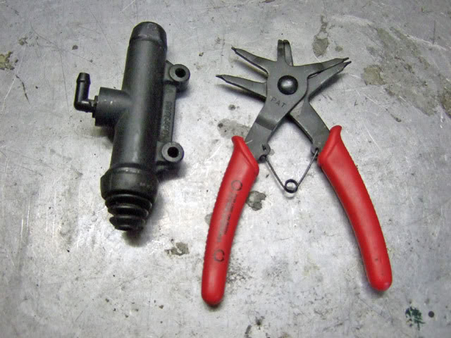

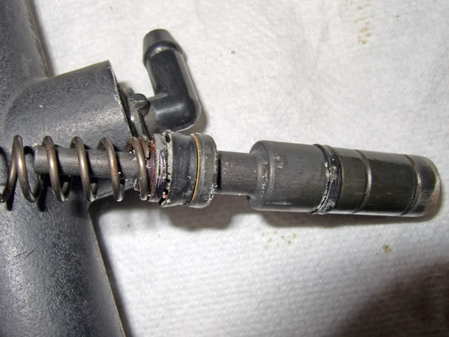

I mean inside the pump. If I remember well there`s a circlip on the bottom side that needs to be removed to get the piston out. I`ll have to check where my spare pump is so I can make a photo.
Re: rear brembo seizing
this one was rather clean. One can see a little of that stuff on the last pic. My first brake cylinder was full of that. To push the piston out use air pressure or a thin wooden or plastic rod that goes through the small hole on the upper side of the brake cylinder. Anything else could damage the cylinder wall and cause leaking. To reassemble put some brake fluid on the seals and push the piston assy gently in while rotating it. Even if your brake cylinder is dirty inside I think your actual problem lays elsewhere.
