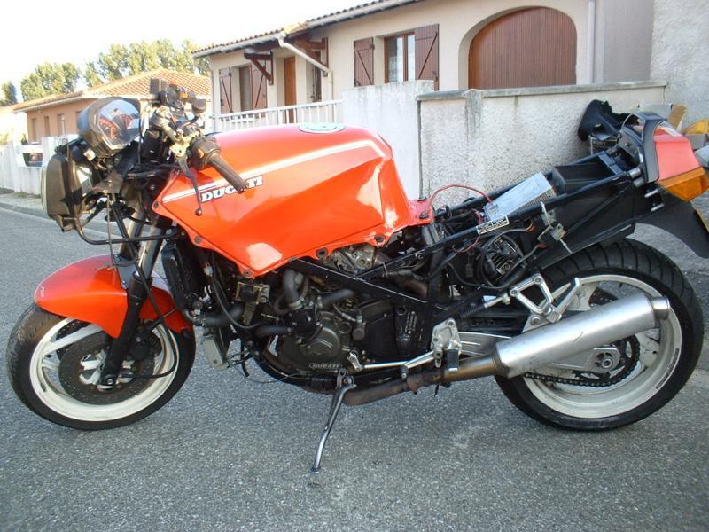

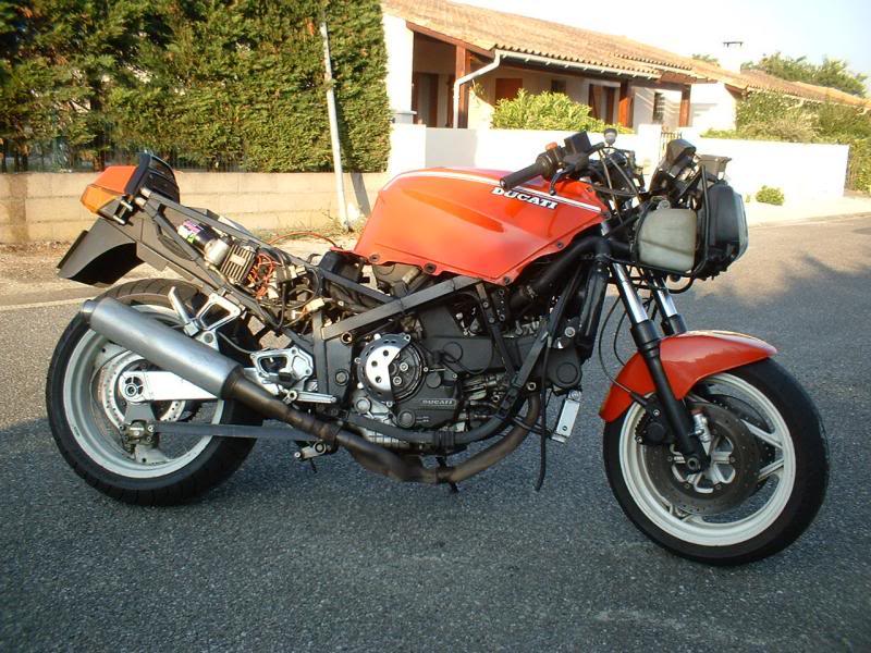

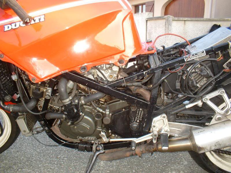

this is a complete 888 engine. (I wonder if the lower side of the tank had to be modified)
- JoKing
- Posts: 362
Re: Food for thought
Definately. And with 17 inch wheels, there would be a clash between the front wheel & the oil cooler/cylinder head when the fork is fully compressed. (At least with the 996-Engine)
