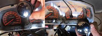

2. At the other end there is the readout gauge. This could either be mounted on the dash where the clock goes or on that dash strip.
3. Wiring
Follow the Innovate instructions to wire up the the gauge with the Wideband controller, the gauge and the bracket. I then enclosed the bundle of wires in some heat shrink (not shrinking it) and bound it up in electric tape. The Innovate supplied bracket that the wire bundle is attached to can now be bolted on to the horn attachment.
This also requires a fuse for the power/red wire and, to attach it to the horn, wiring into the horn green wire.
4. Connect up the Wideband sensor and controller. The wire from the sensor can be fed up to a point on the frame and likewise the Wideband controller can be fed from the horn attachment to the same point on the frame and the two connect up.
4. Calibrate the sensor. In the picture above the small circle is around the small red flasher and the larger red circle is around the red push button. These are used to calibrate the sensor - which is done with the sensor out of the exhaust pipe. After doing that screw the sensor back into the exhaust.
6. Done :-) Now when you start the bike it takes a few seconds and you then get a readout on the gauge. Here the gauge is showing 13.2 at idle. 12.8 – 13.2 seems optimal across the jetting range with early 12s to late 13s being fine. The figure is the amount of air to one part of fuel – known as AFR:
