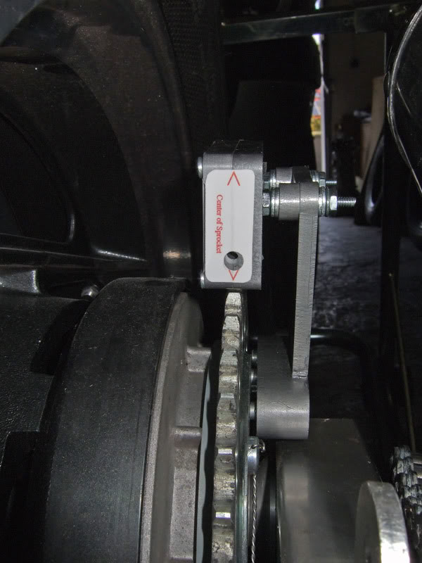

Once you have the wheel square, then you can see where the rear sprocket is aimed, and hopefully its at your front sprocket.
I used a laser tool that works pretty good.
I checked both sides of the sprocket just to be sure.
In my case, I used a sprocket carrier from a 750SS and a big offset front sprocket that has a washer welded onto the outside. So I brought the chain line in as much as I could on the wheel, and as far out as I could with the C/S sprocket. I got lucky that they aligned perfectly.
So, you can see that the stock chain slider won't work. I'm cutting up one from a 750SS and reshaping it. I'll let you know how it works.

- that alignment tool has a conical endpiece and the rod doesn`t seem very thick. Isn´t there a risk that it bends when pushing the conical endpiece in the axle falsifying the result ? (it seems to have a slight bend in the third pic)
- also did you set the chain tension adjusters to the 0 position or fully to the front before tightening the axle and checking alignment ?
- what reference did you use to center the swingarm and rear wheel the front wheel, the frame or the engine ? Often an engine doesn`t sit centered in the frame and hence the rear wheel is offset in the swingarm to align with the front wheel or the whole swingarm is slightly offset.
- that CAT laser, how does that work, what reference do you see at the front sprocket ? It interests me because the one I have comes with a bracket to center it on the sprocket so you see the laserpoint exactly on the teeth of the front sprocket. I was thinking of getting that CAT tool before I found this (cheaper) one.

Yeah, its a bit flimsy bit of kit, but you can get the feel for it if its the same both sides. You could also measure it, if you had a decent reference point.paso750 wrote:Phil,
I have several questions:
I set the chain adjuster to the middle of the range so that I can also confirm the hash marks on the swing arm. This one was pretty close, but others have been off a bit.paso750 wrote: - also did you set the chain tension adjusters to the 0 position or fully to the front before tightening the axle and checking alignment ?
Since I am using a stock swing arm, I didn't do anything to shift that left or right, and the tire is pretty much centered in the swing arm, so I called it good. Not scientific, but close enough.paso750 wrote: - what reference did you use to center the swingarm and rear wheel the front wheel, the frame or the engine ? Often an engine doesn`t sit centered in the frame and hence the rear wheel is offset in the swingarm to align with the front wheel or the whole swingarm is slightly offset.
The CAT laser shows a dot straight forward that is about the width of the outside plates of your chain. If I had a chain on, it would shine a laser point right along it. I used a bit of paper with a notch cut into it and placed it on the front sprocket. I then confirmed that the laser point was the same distance on each side. Again, close enough is good enough. I'm within 1mm or so.paso750 wrote: - that CAT laser, how does that work, what reference do you see at the front sprocket ? It interests me because the one I have comes with a bracket to center it on the sprocket so you see the laserpoint exactly on the teeth of the front sprocket. I was thinking of getting that CAT tool before I found this (cheaper) one.
Out of interest, I should do the same to my ST4s just to see if that rear wheel is square. I took no measurements of the frame or rest of the bike, as its not yet built up, and i just got the frame straightened.

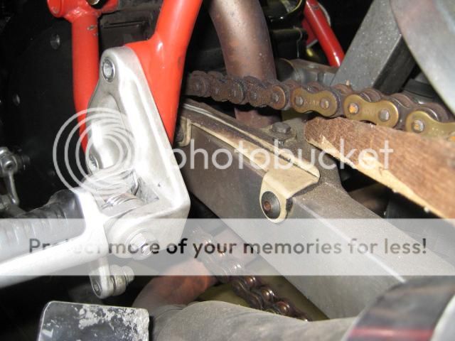

The chain line is now perfect from front to back, but the stock slider would be useless, (even if I did have one) since the chain line moved outboard. I took one from a later model 750 SS (different from the 900SS) and cut it up, and welded it. I simply bolted in place, and use a soldering iron to melt the junction. A little filing to finish it off and called it good.
Of course, I simply aligned the slider to the chain, then fixed to that position.

My 1st chain slider , before I found a new one , was just a strip of plastic about 8mm thick, 25mm wide and long enough to do the job . I drilled 4 mm countersunk holes in it and drilled and tapped the swing arm , heated and bent the plastic and screwed it on . Worked a treat and if you didn't know you would never know
