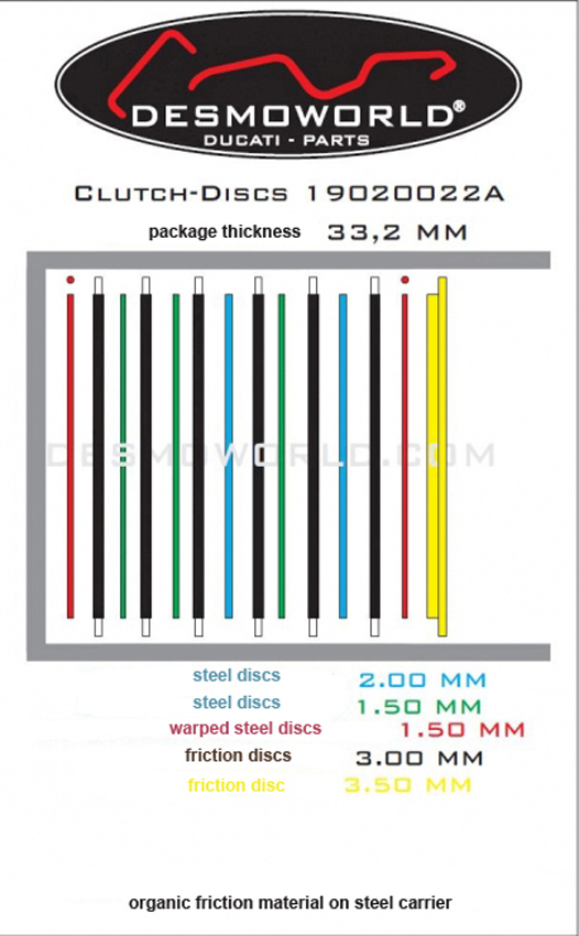

The dots on the steel plates identify the warped discs.
While you have the clutch disassembled measure the thickness of each steel and friction disc and the whole clutch package. Clean the guide pin on the inner side of the pressure plate and grease it (but only very little and remove excessive grease!)
When assembling I`d rotate the outer cutouts of the steel discs by 90 degrees just to prevent a possible inbalance that could occur if they were all ligned up.
I never noticed marks on my clutch but looking at a spare now my pressure plate has "1" and "2" stamped on it
(that may just say that the bolts should be tightened over cross, who knows)
The only manual I found that mentions something about aligning dots is a Monster manual, but that clutch is different.
