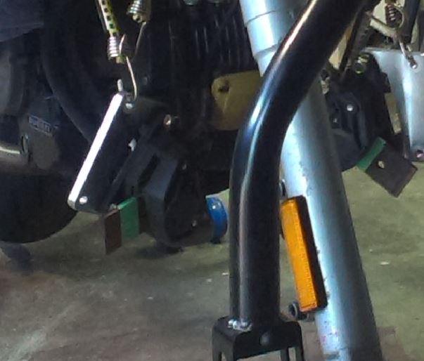

Ok, so I go to bleed the front brakes today, now mind you I have 40 years with motorcycles. I currently own 7 Ducati's, a Buell 1125r & RC51 and do most of my own maintence.....so I'm looking at the 750 Paso and think how the heck is anyone supposed to bleed these bloody things? What was Ducati thinking when they did this set up? I'm at a loss and need to come to you guys asking for advice....so how do you do it? :cry:

Swop the master cyl hose union bolt for type with nipple. Put one on clutch side as well.

That would make it easier...thanks for the tip....now how about getting the caliper out from the wheel....I tried wiggling it and bending, etc. and can't seem to get it out from the rim?

Pull and push the caliper against the disc to retract the pistons a smidge and then you should be able to wiggle it out.

All the bolts holding the hoses , and the brake light switch , will need to be cracked to allow hidden bubbles to escape ,( Ya gotta think like a bubble :) ) . They are a bastard of a thing to bleed ...................... its not you :lol:

I bleed my 906 brakes yearly, the easiest way I have found (and the cleanest) is to remove the entire twin caliper assy intact from the bike and place it all on the drainer. Then I suck/pump new fluid thru each caliper the old way - release caliper bleed nipple, pump and hold lever, tighten caliper nipple - repeat. This allows me to first push out pistons a little way, clean and add a little grease to the piston sides then I'll push them all the way in and replenish fluid. I attach a clear tube to the bleed nipple for ease of use. Of course if you are changing seals then this isn't for you but it works well for new fluid and there is no chance of splashing fluid on the ancient paint work.

With the 17” conversion on my Sport, can’t actually get to the bleed nipples, so the procedure is to go through all the kerfuffle of removing the front wheel, re attaching the caliper’s to the fork legs, put the axle back in to hold the forks in place then bleed them as you would on any other bike, obviously using some form of wedge a similar thickness to the disc rotors to keep the pads apart, I just use a piece of Masonite with the edges bevelled.
Then put the mongrel bastard all back together again, truly is a pain but works for me. :banghead:

Thanks....this was the plan at first but it seems like a PINA getting the calipers out from the wheel. I'll get them dirty dogs off! Thanks for the help guys!
