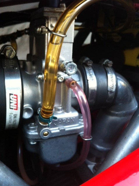

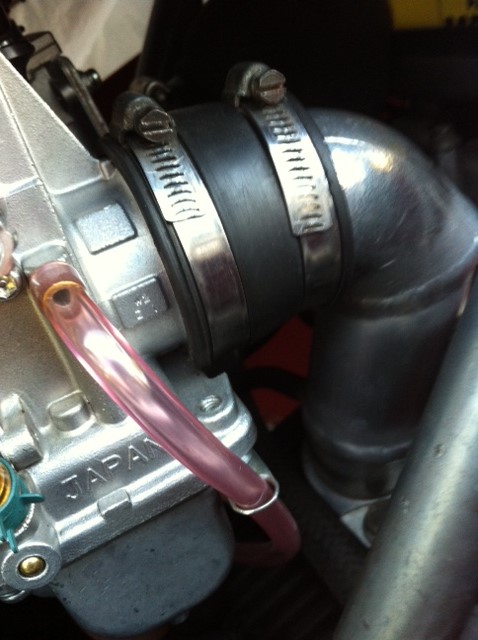

Sean, go all out and custom make one like this, so your carb. can sit straight.
- intake2.jpg (78.14 KiB) Viewed 24285 times
- intake1.jpg (82.4 KiB) Viewed 24285 times

The Mikuni carbs come as a pair...joined at the hip...as it were, unlike the single delortosNunodeo wrote:Sean, go all out and custom make one like this, so your carb. can sit straight.

Re: 900/750 ss/monster inlet manifolds
or Mikuni TMs

I'm fairly new to the 750, so I can't comment on the stamping. All I know is that I took an intake from a early 2000 750, cut it up in 3 pieces, got it re-welded, put it on, and the bike is finally running well.

Sorry guys, the intake I cut up for my 750S was from an early 90's 900, not an early 2000 750.
