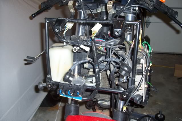

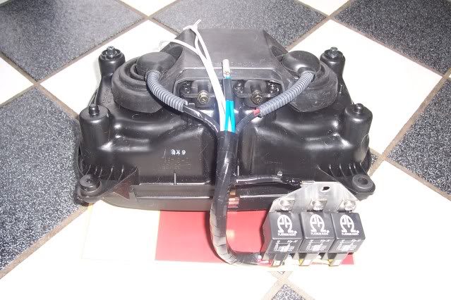

Ducati Paso Dual Headlight Conversion:
This conversion utilizes the spare fuse location in the Paso fuse block. It also reworks the Euro headlight switch to allow a single low beam or dual low beam operation. Disassembling the Euro headlight switch is not for the faint of heart, there are spring loaded balls inside and wires that need relocating. The alternative is to add an external switch to the handle bars.
The headlamp assembly that fits the Paso is Yamaha P/N 1LJ-84303-A0-00, it sells for about $135 plus shipping , here is the site I purchased from: http://shop.yamaha-motorcycleparts.com/ ... /home.aspx . The models it fits are Yamaha 86 FZ750S, 87 FZ700T & TC, and 88 FZ750U if you are searching for one used. The front housing is actually the same as the Paso if you find a housing with a broken ear. New ones come with 35 watt bulbs that you can replace with 55 watt H4 bulbs. Some spacers may be required at the top two mounting points if you run out of adjustment down.
A bracket needs to be fabricated to mount 3 relays. The high beams can share a relay, but independent low beam relays are required if single headlight operation is desired for minimizing battery drain. The bracket can use the horn mounting bolt to mount the relay bracket. Care must be taken to dress the cabling in the tight space behind and under the headlight. Image

Really neat job and great explanation :thumbup:

Pics mounted w fairing?
Is the light better IRL on the road at night?

Thanks, yes the light is way better with both lows or both highs on. Riding with the single low beam is great for daytime and well lit roads, kind of like the stock headlight. I mean't to post this in the tech section, I will do that and add a picture with the fairing on :)

9 points to Shelboss, as he did great job with very good diagrams... If he could add some cute girls to show all those parts(!!!), then i could give 10 points... :thumbup: nice job anyway.. :lol:
