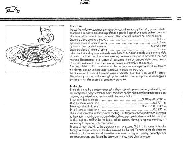

Quick question: According to my manual "new rotors" should measure 0.196-something and the wear limit is 0.177-something. What are do your rotors measure?
The brembos I put on my bike a while back have some pitting in them and I have a new/used set of OEM rotors I'd like to bolt up. The new/used ones measure 0.1556 and the ones on the bike measure 0.1554 and my old warped ones on the shelf measure 0.1554. I was thinkin "woa!" all of these are beyond the wear limit??! Thanks.

just have a look at the wsm
- Unbenannt-1.jpg (137.43 KiB) Viewed 9219 times

Yup thanks, I have the manual as mentioned in my first post. Im looking for some actual measures.
- Posts: 5570
Re: Looking for some rotor measures...
new discs have 5mm and 4.5mm is minimum. You find that info also in every brake rotor manufacturers catalogs. The min. thickness is also stamped into the brake rotor. You won`t find any other info than that
