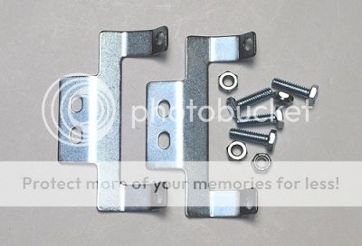

DCB-1 - This bracket kit is used to aide mounting the DYNA coils which we sell here onto your motorcycle. These bolt directly onto the coils, then you can use the other holes on the bracket [or drill other holes, or bend the tabs etc] to attach them to your motorcycle. They are a direct bolt on kit for various BMW motorycles but can be modified to suit other applications such as your bevel drive Ducati as well. We have found that they are quite useful to speed up installation on just about any brand bike. The kit comes with everything shown, 2 brackets and the bolts and nuts needed.
Price: $21.79
Part # : DCB-1
Manufacturer: DynaTech Ignition

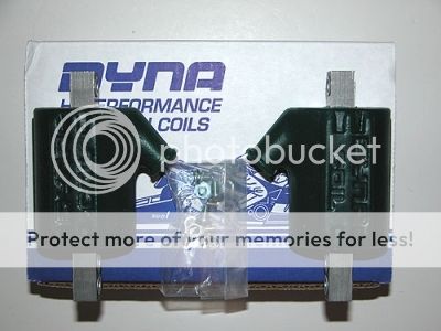

I got mine at bevel heaven for the 906 to mount a pair of 3 ohm DC3-1 coils and have had no issues with the Digiplex
DC3-1 - DYNA coils set includes 2 coils, mounting hardware and instructions. Although these 3 ohm coils can be used for general street riding, these are better served for higher RPM race applications. Dyna coils feature; No exposed laminations to rust and degrade performance, High voltage and primary terminals machined from brass, Ultrasonically welded and sealed against moisture, Compact size fits easily under stock covers, Peak gap current in excess of 50mA, High impact thermoplastic housing, Over 40,000 volts per output, Accepts 7 to 8.8mm wires and includes a 1 year warranty. Choose either the coil kit only or the coil kit + the Dyna 7mm wire kit. NOTE: These kits well NOT work for early 860GT with the orange transducers Ducati Electroteccnica Ignitions
The DC10-1 are the preferred replacement for the Digiplex
DC10-1 - DYNA coils set includes 2 coils, mounting hardware and instructions. Use these 5 ohm coils for general street riding. Dyna coils feature; No exposed laminations to rust and degrade performance, High voltage and primary terminals machined from brass, Ultrasonically welded and sealed against moisture, Compact size fits easily under stock covers, Peak gap current in excess of 50mA, High impact thermoplastic housing, Over 40,000 volts per output, Accepts 7 to 8.8mm wires and includes a 1 year warranty. Choose only the coil kit or the coil kit + the Dyna 7mm wire kit. NOTE: These kits well NOT work for early 860GT with the orange transducers [Ducati Electroteccnica Ignitions].
hard to see the color in the pictures the dc3 are green the dc10 are black
