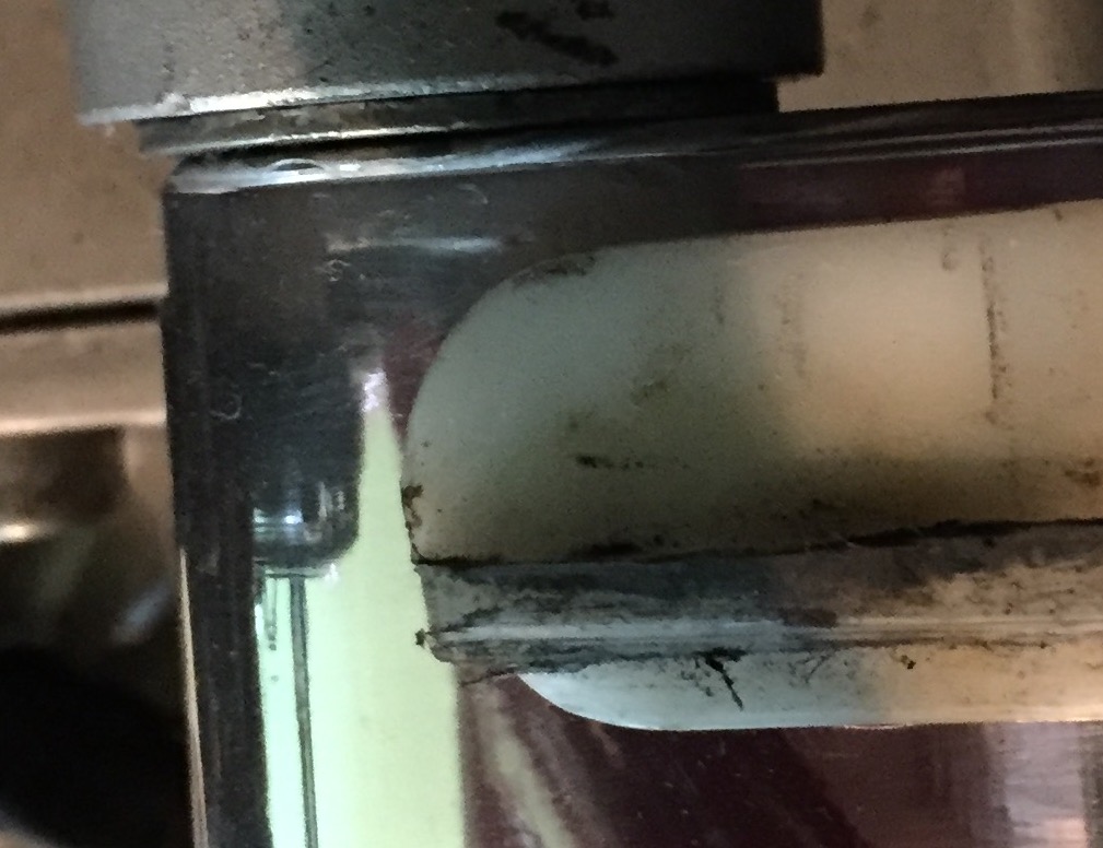

I just reinstalled the swing arm on my 900. There is one washer/spacer on the inside of each side of the swing arm, resting between the swing arm and the engine cases.

Here is a photo of the shim between my swing arm and the engine cases.

Thanks for that ... Threw it all in this morning ... Got .1mm as per manual so nice and snug
Replacing bearings and seals easier job than I thought it would be
